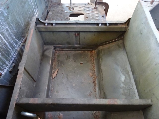

I put mine in the hole for the aux power outlet since my truck wasn't equipped with it. (Just a block off plate.)
Re: 40000 BTU heater
DSC01131 (Small).JPG (102.85 KiB) Viewed 1559 times
W_A_ , sure would like to see more pics of your install, I did some measuring under my seat, and I don't see how you can get a 16" unit in there.
