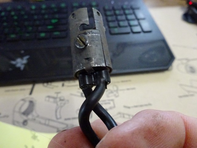

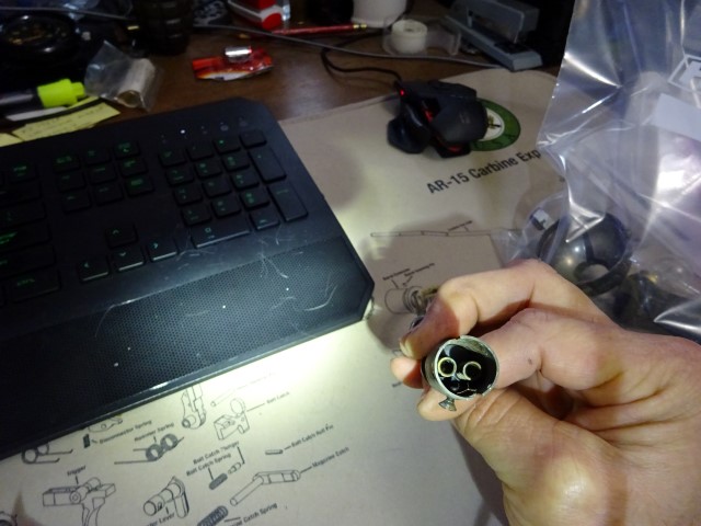

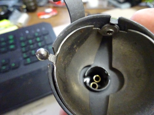

OK, here are some pics of mine.

Re: Map light bulb??

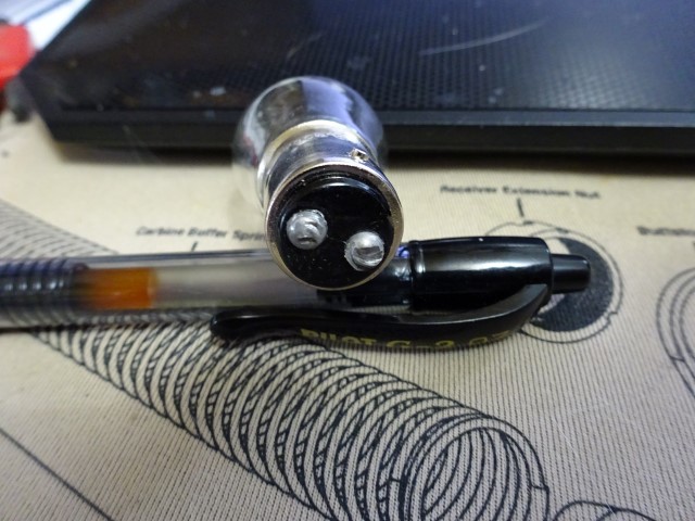

My bulb has two contact points on the base, and there are two springs in the base of the light. I have two of these and one had a single contact bulb in it- it contacted both springs which seems to me to be a direct short as the wires are attached to both springs (one each). The bulb that has two contacts (pic) has a single filament. This bulb came from MWM in the light.
DSC01017 (Small).JPG (102.62 KiB) Viewed 1832 times
Posts: 1241
Double contact, single filament should be 1254, 304 & 624 from dimmest to brightest.
