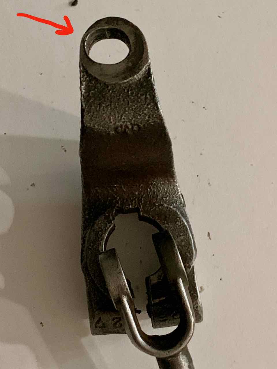

Post by outpostm37 »
Make sure you check these on both the bell housing and inside the driver's side frame rail.
This one is ready for retirement.
clutch linkage arm (1).jpg (81.86 KiB) Viewed 2392 times

its surprising how fast they can wear. specially when introduced to dusty gravel roads. those pins are part of my pre trip oiling as well as both sides of the bell housing, brake, tcase linkage roll pins and throttle links. not to mention all the nipples

One of the weak links. Give all the grease zerks on the pedal shaft and elsewhere you would think these linkages and arms would have been a little more beefy for the MV application? It is the same link on a DeSoto :lol: They are easy to build back up with braze. I try to keep mine cleaned lubed every so often.
Re: M37 clutch linkage arm
Precisely why I changed all those on the clutch and transfer levers to Heim joints. We drive these trucks far longer than the military ever did.
