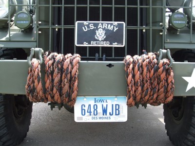

Hey Crew.
Somehow while talking about "pioneer tools" we got off onto license plate mounting locations.
We mounted our front plate on a small set of hinges. Two 1/4" holes in the bottom towards the rear of the bumper flange.
Folds up nicely for parades. (The Retired Army Plate belonged to my Father)
The Army plate is attached to the grill with "metal wire loom clamps" & stainless screws with acorn nuts.

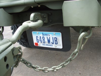

Our rear plate is mounted on a heavy rubber truck mudflap. I do not have my license-lamp installed yet.
It will also be mounted to the "flap" with an extra ground wire attached.

I like those ideas, Tim. It looks like a good way to comply with the laws and yet quickly conceal them for parades and displays.

I like the hinged plate....now all you got to do is hook it up to a fording cable...if you need on the fly anonymity :mrgreen:

Good ideas Tim.
How to you illuminate the rear plate when driving at night is my problem.

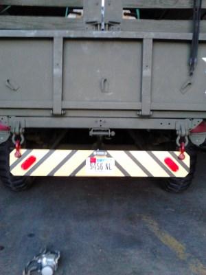

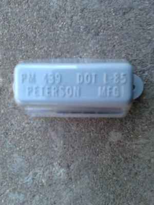

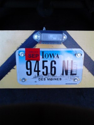

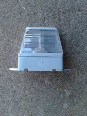

Sealed beam trailer lamp. 24 volt, just run a ground wire. Cost about $7 each.

Run the same lamp on my trailer.
