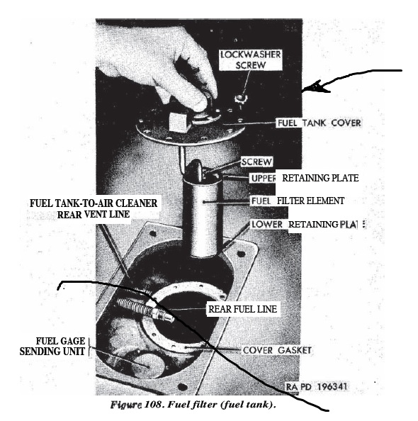

and oh... Jess... your seeing the screws that hold down the plate in the bed, the one that is removed to get access to the fuel tank and other covers I am talking about.
thanks for looking for me though....
still wonderign on the fuel tank cover size.. looks bigger than a #8
see attach pic I had bbeen given in a previuos post some tiem back
fuel filter2.jpg (122.26 KiB) Viewed 1322 times
Posts: 950
Re: Fuel tank cover screw size?
choppa wrote:yes, thats the screw I was needing, the 10 that hold on the fule filter cover plate.
hummm.. #8 eh? thats weird. the screws that hold on the sending unit are #8, and they are definately smaller then the ones I seek...
thanks for looking... but still I am thinking I need a bigger diamter/size for the filter cover... can you double check your book or are you 100% positive you got the right one.
thanks again
Choppa, I believe those are the right screws for the in-tank filter cover. I re-checked my parts book and that's the part number and description, and the quantity listed is 10. Those are spec'd as sheet metal screws, not machine screws, so it's possible that, after multiple disassembly and reassembly over the years, someone has gone to a larger size sheet metal screw if the holes in the tank were stripped.

humm.. got to thinking.. a #8 thread cutting or sheet metal screw IS bigger than a #8 machined screw.. thats it I bet.
thanks so much!!

I did another quick check on those 10 screws and washers that Elwood posted for you. There may be some difference between US and CDN production or age but I have the same listing for the washers but the screws are listed as CC/ 160239 Screw, mach, pan head, cross recessed cat no. 12-24 NC by 1/2 Qty - 10
Its possible they have been replaced by a self tapping type similar to what is used in marine fuel senders. You can always go to a larger size and tap them to fit if the originals don't hold well.

I couldn't find the screw at either of the two hardware stores in town. I tapped them out to the next size larger metric screw, which was only a hair larger if I remember correctly

ahhh ha! I knew it.. they are 12-24 screws. 1/2 in long.
ok good.. thanks again to all reponders!
