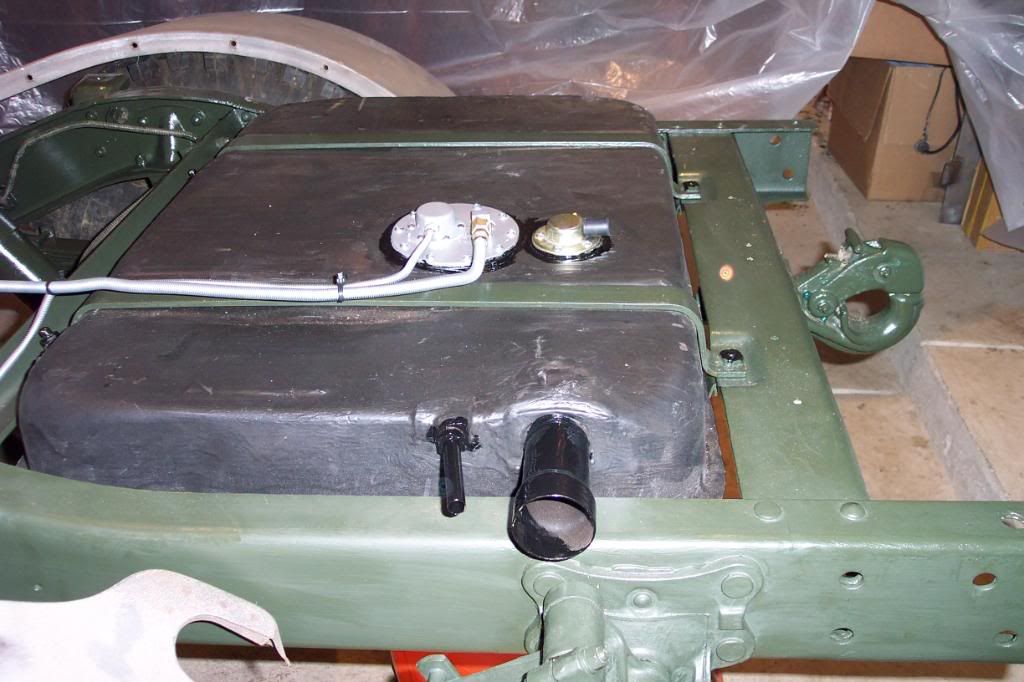

I'm in the process of re installing my tank, and it has been some time since i removed it.
Logic tells me that the two heavier duty straps go on the bottom, but in trying to make an arrangement to work, i can only make it happen if the two lightweight straps go under the tank.
an anyone confirm this, i did take pictures, but i cannot zoom in enough to make it out.
Thanks

Sydney37,
The thicker straps go on the top, even down under, the thinner straps go on the bottom.
