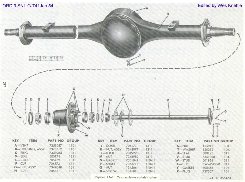

Perhaps this will help get us all on the same page.

Which seal? D or U
Old numbers for D (ORD# 500174) are Napa 49426 or CR 28116
Old numbers for U (ORD# 500125) are NAPA SS49857 or CR 20766 or NAT 6077

Re: Rear axle oil seal...
Well I hate to be the bearer of bad news, but I'll go ahead and be the first to tell you that your efforts were time wasted in making a seal from silicone. Seal "U" is the one that seals oil in the axle housing out from the hub interior and wheel bearings. Oil in the hub will wash all the grease from the bearings. The leak you previously had at the axle shaft flange kept oil from entering the hub and saved you a larger mess. Unless you have oil of sufficient quantity in the hub, (which should not be) the bearings can be starved for lubrication. Unless you have a really good inner hub seal, your oil leak will now appear at the inner seal on the spindle. This time your brake linings and drum interior will also be saturated.Tyroma wrote:Arg! Where were you yesterday? Just kidding...I just got the assembly put back together. I used some Permatex Ultra Black gasket maker to make a new seal inside the seal housing (part U), then I used the two gaskets on either side of the housing with more Permatex on both sides. I'd be surprised if it still leaks! But if it does, now at least I have the part mubers. Thanks!
Ty
The part# Wes offered is a seal that will fit the application, (if it's still available, not sure) but is leather and not a rubber lip seal. I never saw one used (leather) that would hold back oil from entering the hub. A waste of time to install it. The seals we use are buna-N, and do a good job as long as the mating surface of the spindle nut is good.
I'm just offering these suggestions to save you time and $$, and quite honestly, there is no need in doing something that as a given fact will not work. Good luck.
Hey Charles...
Not to worry about bearing bad news...better to know, and we all appreciate your taking the time to educate us!
Now do those Buna-N seals that you used have the metal disc (as shown in the above diagram) or is it just the oil seal? I ask because the left and right are different on my truck. On the passenger side, I was able to get SKF seal 20538 for it...perfect fit...and install it into the disc. On the dirver's side, though, the seal was of the leather type, and of a totally different diameter.
