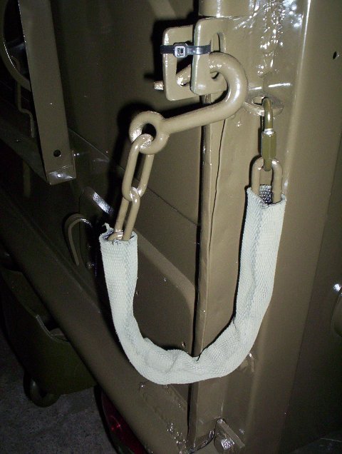

On another note, I installed my pioneer rack and discovered I only had three of the original mounting spacers. Two were very rusty and pitted. I subbed them with some 3/8" solid shaft collars and they are nearly identical. I also used Parker woven 1.500" hose wrap sprayed OD for my tailgate chain covers. Looks real close to the real deal. The man at the Mega Fluid store gave me the wrap for free when I told him what it was for :D

My can holder fit no drilling, not any help there David? Any pics of the Parker Woven Wrap, I used a canvas sleeve form WEE BEE Webbing.

Hear is the chain cover from "hose wrap". I have to hit them again with the paint as the cloth really soaks it up.

Dave. Does the tool rack on the tailgate hit the bumpers when you fully drop the tailgate ? :?

Re: Front Fender welts & cost saving part subs
Sal,
I don't know, I have not dropped the tailgate beyond parallel? I will have to check.

I was just wondering because I dont have my tailgate on yet but it seams really close. Would you happen to know if these tailgates drop like the ones on a 2 1/2 ? :?
If you don't hook your chains up, you'll have some scaring/scraping o' da' paint!
