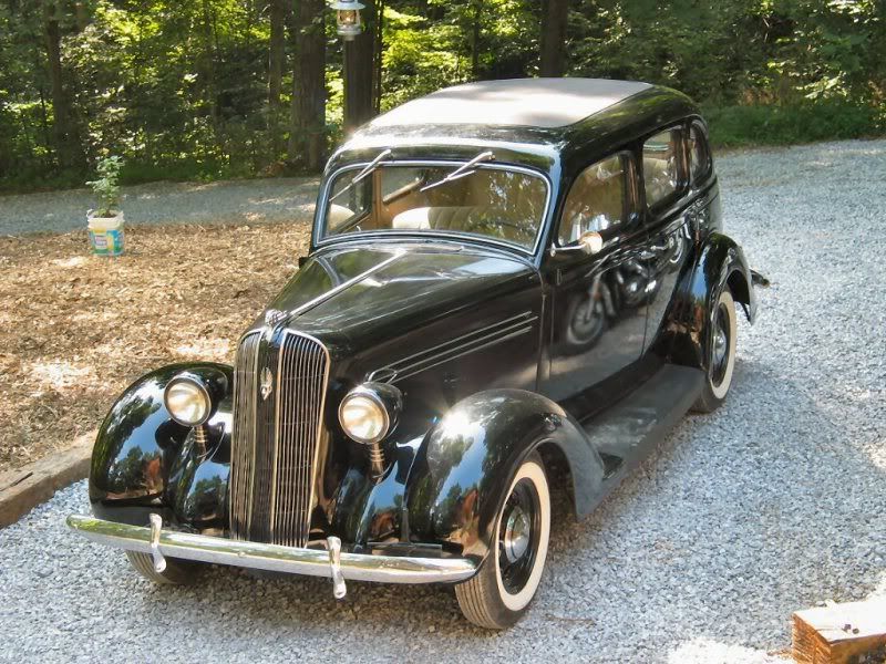

Off topic, but with this one coming home, my Plymouth will have to go to make room in the garage. Anyone interested in a '36 P2?

Nice Car. Dad and I are in the process of building a '36 Buick.
I say build a bigger garage. A man should have more than one toy!
