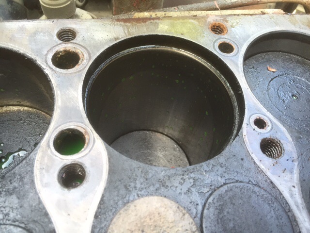

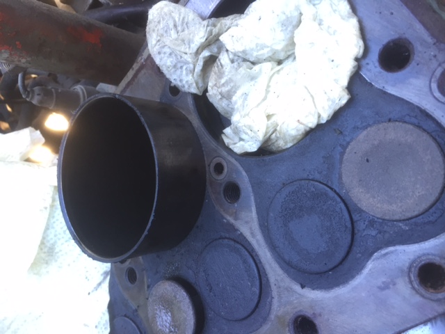

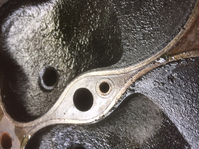

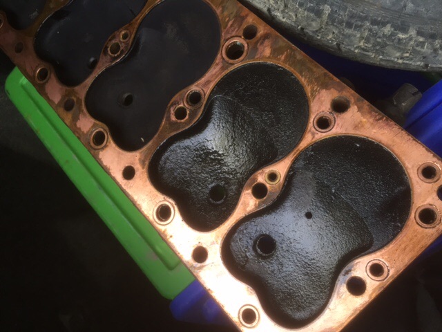

Leaking between 5 and 6, the entire head has big scratches through it, as if the "surfacing" tool used was actually a heavy screwdriver. Also check out the sleeve in cylinder 2, they're all sleeved but #2 slid down 3/8"
I smell a rebuild coming. I think I'll use my other block, maybe a better candidate.

man thats a lot of coke in those combustion chambers
if that sleeve slid any further it would start kissing the crank
hmm those sleeves are pressed in cold ...hmmm did the temp up there get down to -69.5F
the asbestos gasket can take a lot of abuse it is thicker than say the felpro. had one bouncing around under the passenger seat for years. road side repair was needed 20min later (fingers crossed) I was on the road. head has not been off since
I would use the new one and keep the old one under the seat....or drive the sleeve back up, use the asbestos gasket, bolt the head back on and rebuild the other motor.

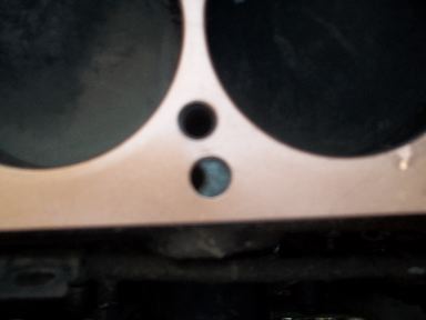

wow that's out, I have never seen a 25inch gasket that far out. I have seen heads and blocks with poor quality control mostly Plymouth and Desoto where all the coolant passages in the head are out by a mile. the ind, T, are much better(usually) .... crown heads and blocks seem to be the finest in the dcpd family.

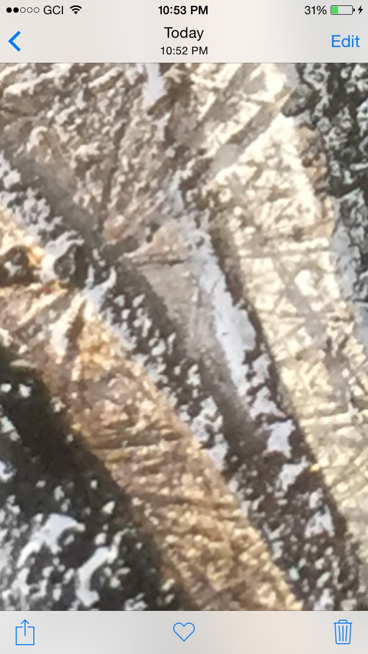

That's a good thought, not too much trouble involved. Wonder how to drive the sleeve back up? Here's a close up of the surface finish of the head. This is without the gasket, it just looks shiny because of the imprint.

i've seen many heads that look like a gas axe was used for the resurfacing.
is it easier to just pull it ........hmm.....well you could drop the pan and the rod cap, push the piston out the top. then take a round plate (with a hole in the middle) the size of the OD of the sleeve, some ready rod or a big bolt and some nuts along with a top plat (of something substantial) fill the sleeve with dry ice then tighten the nut/bolt. maybe use some red lock tight. I think the sleeve is too had to peen in place like one may do to a spinning Uj cup.
or a three jaw puller attached to a slide hammer

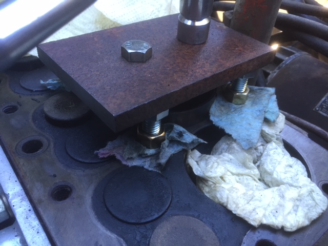

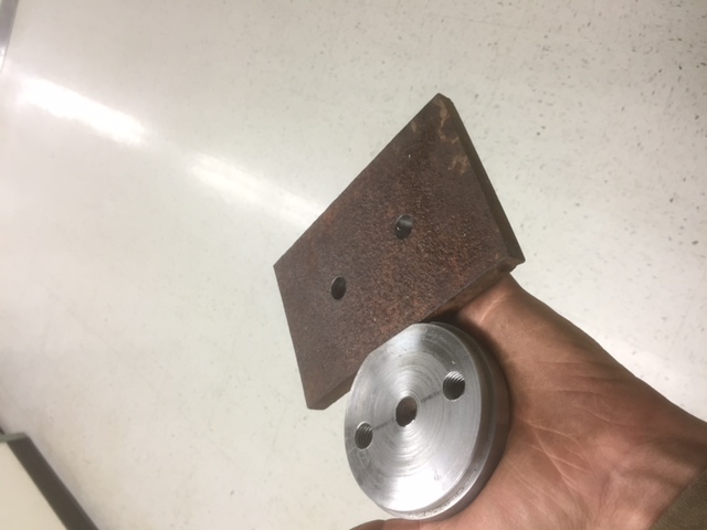

well, i got the sleeve slid back up today! project has been on the back burner all summer, since i've been in Nome driving my other truck and haven't had a chance to work on this one. but, today, i got a few hours to play with it! found some huge bolts at the hardware store, they are 1/2" 13tpi, 10 inches long. should have got the 11" or even 12" as it wouldn't interfere with anything and i could have pulled farther without having to reset my "shims" (actually just progressively longer bolts) under the top jack plate.
here's a couple pictures of the process. it's pulled up 1" extra to allow me to clean it up and glue it and press it back into place. i think i'm actually going to pull it up one more inch, with 2" of "high temperature sleeve retainer" at the top and bottom of the sleeve i doubt it will ever slide back down again.

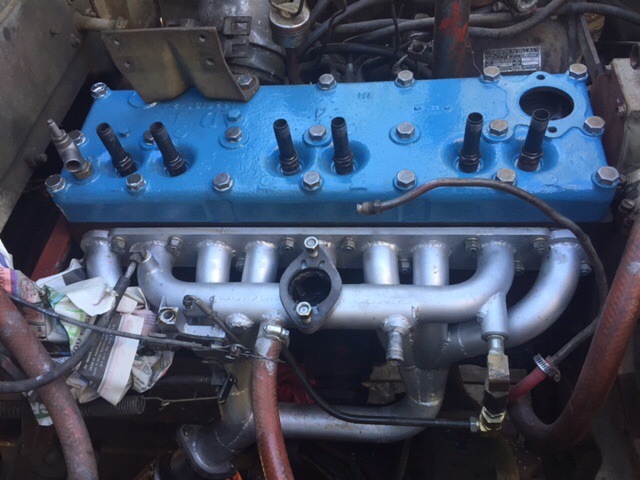

Now since I have some engine enamel left over from my charger, and another hour to kill tonight, I'm gonna make the head Chrysler blue

Almost back together. Oil pan, oil, vents, and carb left. Discovered the water jacket on my manifold developed a leak into the intake. Maybe the head gasket was fine after all. But I'm glad I pulled the head and discovered the dropped sleeve.

Isaac, what are those intake and exhaust manifolds? Are they custom or an off the shelf item?
And what is the red hose/line connected to the intake manifold for? I also see another hose connection point to the right of the carb?
- Posts: 557
Re: Another head gasket thread
That's a manifold and "header" I built, I have a thread on here with lots of pictures of how I built it. Those ports are for a water jacket so that engine coolant will keep the manifold hot. To help prevent icing in the manifold.
