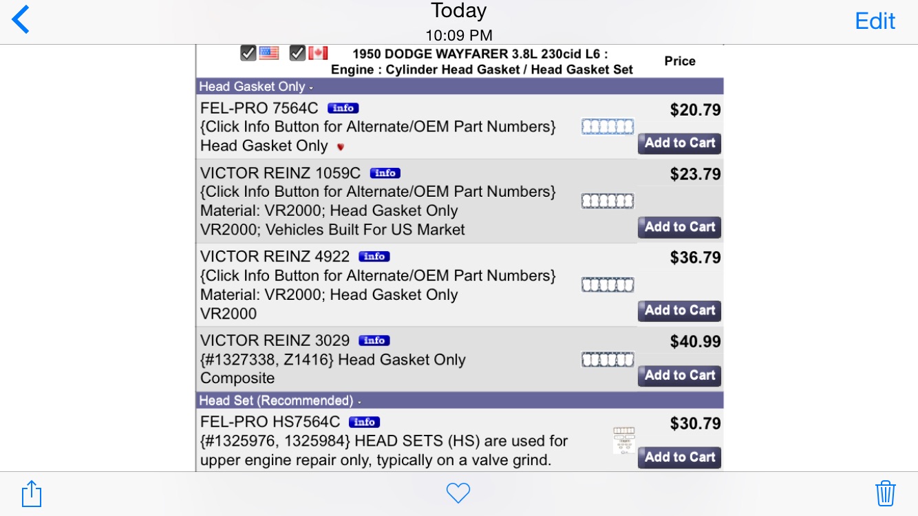

I ordered a NOS head gasket, but are the new composite ones better? Looks like rock auto has 4 different flavors. Any favorites? These in the photo say they fit dodge 230, any reason they wouldn't work? The NOS I ordered specifically says m37.
Aside from checking the block for flatness, and taking head to machine shop, anything else I should check or inspect while I have the top open?

I'll read through it, thanks! i took a look at it before but i wasn't sure if the head gasket you got was just a fluke or if all their head gaskets have the mis-aligned hole. seems very strange that they could sell something if they are consistenly misaligned. what did you think of the quality of it, aside from the off hole? it's cheap enough i don't mind ordering one to see if i have better luck with the fit. but if the NOS is just as good or better than the fel pro as far as quality and sealing ability then i suppose there's no reason to order the newer one.

I ordered the victor reinz gasket, since it was only a couple dollars more. I'll post some pics when it comes to fitting it. Still haven't pulled the head off yet. I'm hoping I don't have to do anything to the block.

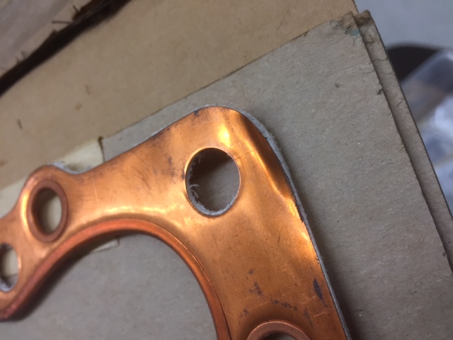

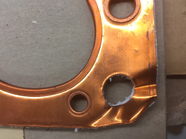

both head gaskets showed up today. first one is NOS copper, off ebay, 2nd one is Victor reinz, new, from rock auto. the price difference was minimal, both were cheap, like $20 for NOS and $30 for VR
laid them on top of each other and the hole patterns appear to match up perfectly.
the NOS one has definitely been around a while. the copper is fairly tarnished, doesn't look real shiny anymore. and looks like it's been dropped twice, on two different corners, so they are pretty buckled and i'd be very hesitant to use it, unless i had no other options.
to be fair though, the ebay seller did ship it free shipping, which is pretty rare to alaska.

Love the copper sandwiched asbestos! Is there a thickness difference?
- Posts: 557
Re: Another head gasket thread
asbestos? i thought it smelled a little funny...
i'll mic them both, good idea
