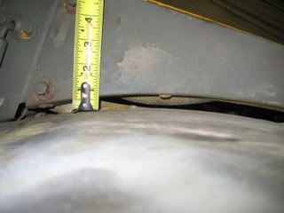

Thanks All for the responces. What I should have done was post a pic or 2
This is driving me crazy! :cry:
I think I have multiple problems. here the first pic and my biggest concern.5/8 inch gap
