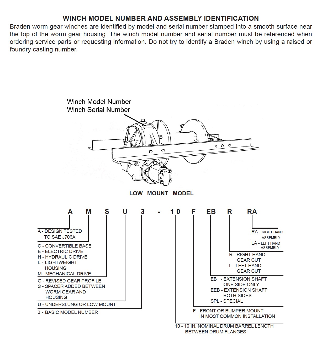

What is the difference between the LU4 and the MU2?
Posts: 953
Re: Winch Conversion
Screenshot 2023-01-18 at 9.15.48 AM.jpg (245.81 KiB) Viewed 1698 times

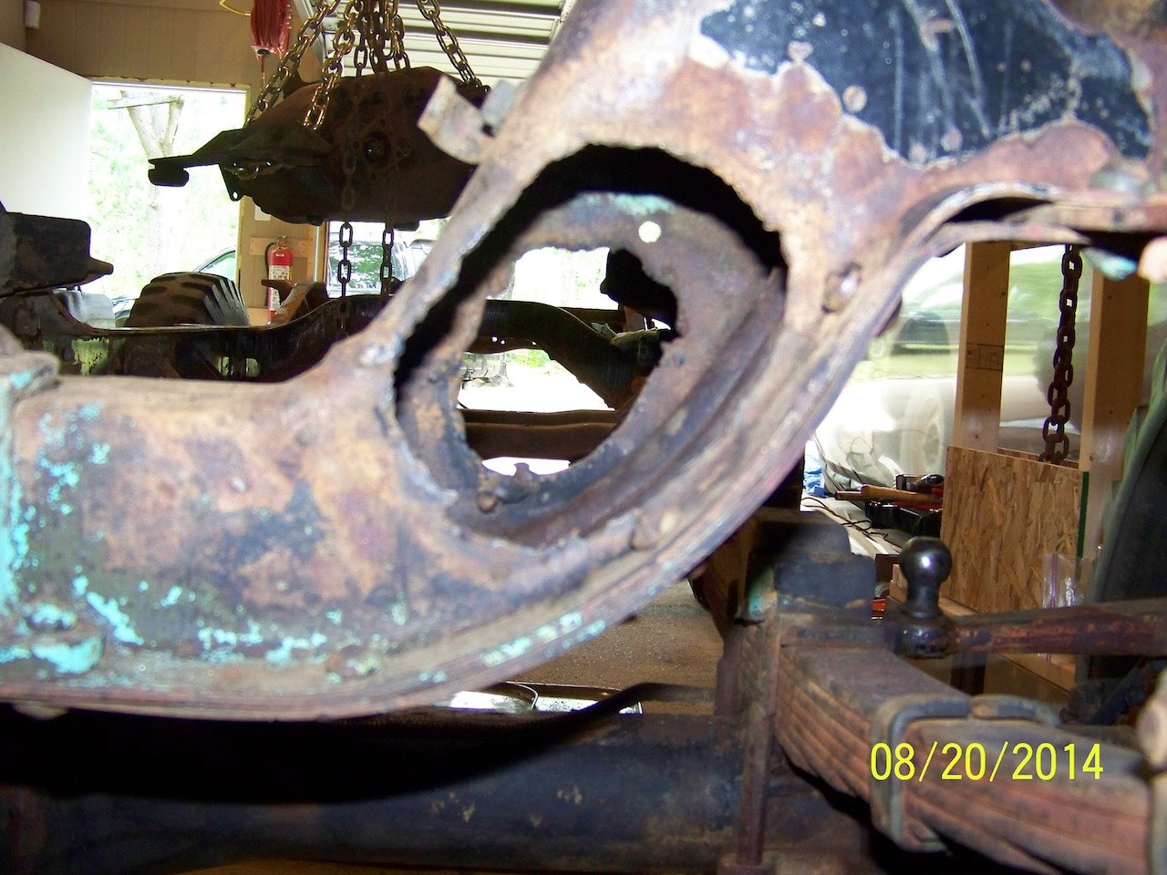

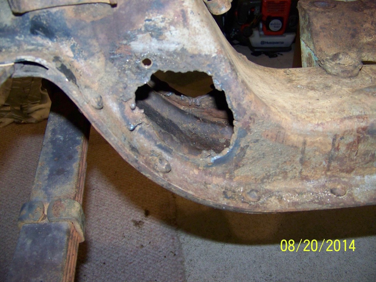

Tom P wrote: Wed Jan 18, 2023 7:30 am I've seen a couple M37 with MU winch's added on.
Besides not being correct the MU is a lot harder to install because the PTO Shaft
Interferes with the front crossmember radiator support.
You have to get very creative or torch the front support.
Tom
Sort of like this...the rural fire department that owned my M37 grafted on an MU2, and did some "creative" modifications to the front crossmember to allow for the PTO drive shaft. :?
