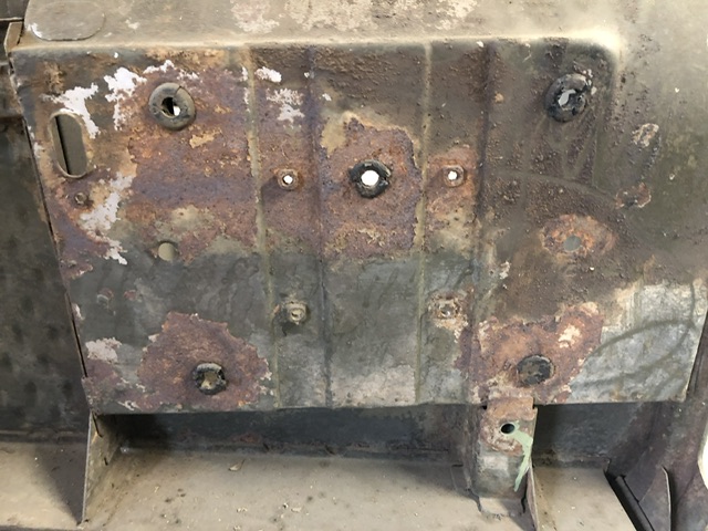

Does anyone have a good picture of the cab floor under the passenger seat? Mine is pretty rusted and I am starting with fresh sheet metal. I am trying to get an idea of what holes are needed through the cab floor in this area. Any help is appreciated!

M37
YEAR: 1954

Thanks for the pic. Mine was so rusted out I didn't realize those holes with grommets were even there. Do you happen to know if these were just drain holes? I am assuming the 4 weldnuts are for holding down the battery box and the oval cutout is for the battery cables to pass through to the starter.
greeno
Posts: 238
Location: Monticello, MN
Re: Cab floor under passenger seat
Post by greeno »
As far as I know, you are correct on all fronts.

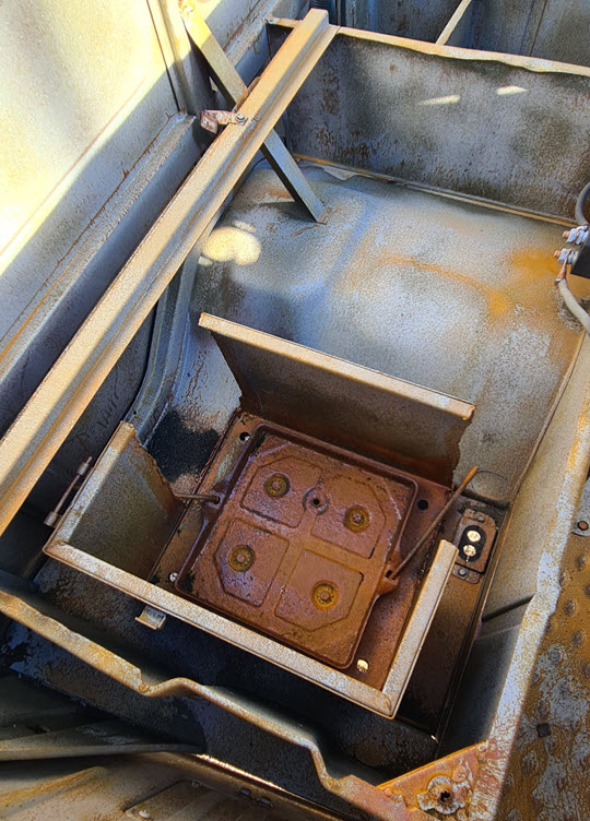

Argie1978
Posts: 181
Post by Argie1978 »
From the top, before sandblasting and removing the destroyed batt box (I have a new one copied from the original). Maybe it also helps.
Battery box before
Battery box before
I have never heard about draining tubes there.

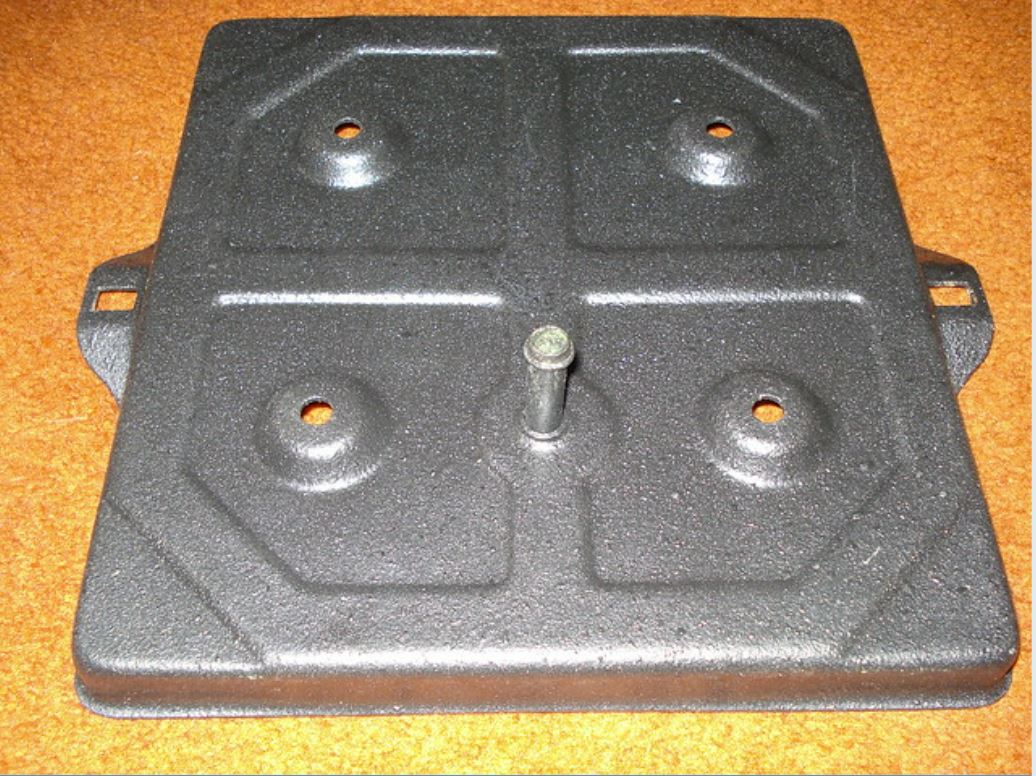

This pic was posted in 2013 that shows the drain tube coming out of the trayImage

Doesn't seem to me like a drain tube but a screw.

Posts: 523
It is a short piece of pipe, with a hose retention ring.
That photo is a bit misleading.
