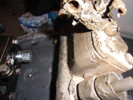

Replacing MC and it looks like I can remove the connections from the old one and instal them into the new one and use my original line hook ups. But, it looks like Bubba put in some sort of valve in the one line and I don't know if this was just what he had in the toolbox to make a right angle connection? Or, is this valve some sort of proportional set up to fine tune the psi in two different lines? Not a petcock, per se, no fluid or air comes out the handle, it just opens and closes fluid going to one line.
Is there any benifit to removing this or leaving it in place? Wondering if this set up would allow the valve to be closed when working on brakes fed by the other line and not having to bleed the entire system as it would close off any air getting to the line that goes through this connection.
master cylinder 2.JPG (33.57 KiB) Viewed 1519 times
Helps to post the frickin picture I took...

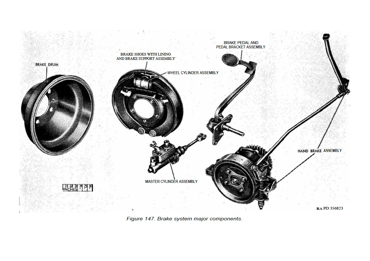

Looks to me like the stock vent valve on top of the master cylinder cover. Here's a screen capture from TM 9-8031-2 Powertrain Body and Frame M37. If you don't have this manual, it would be very helpful, along with the companion engine/clutch and parts catalog.
M37 brakes.jpg (232.88 KiB) Viewed 1517 times
The valve is in the vent line (not the output pressure line) for the reservoir. The valve is for use during deep water fording.
