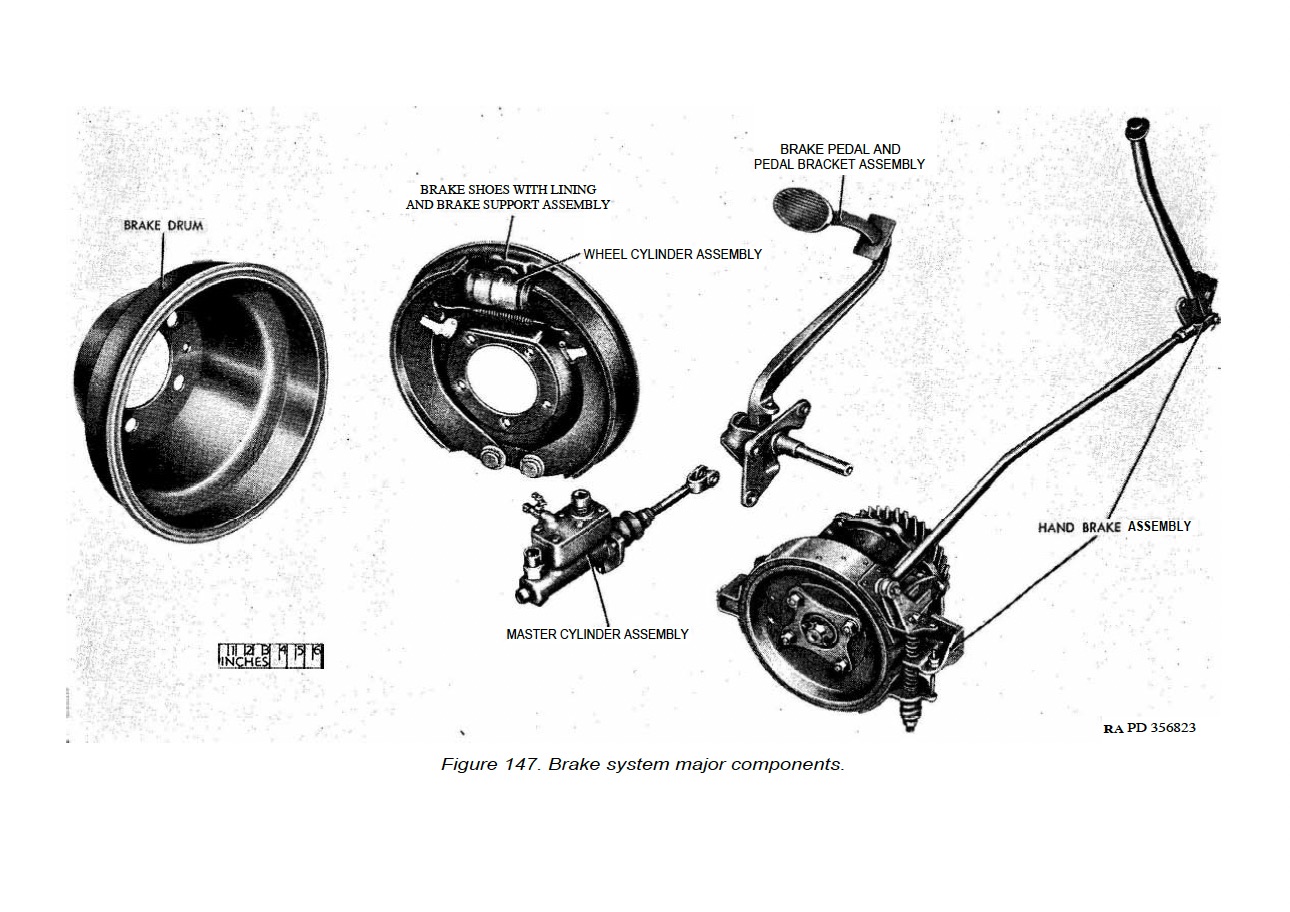

Looks to me like the stock vent valve on top of the master cylinder cover. Here's a screen capture from TM 9-8031-2 Powertrain Body and Frame M37. If you don't have this manual, it would be very helpful, along with the companion engine/clutch and parts catalog.
M37 brakes.jpg (232.88 KiB) Viewed 1501 times
The valve is in the vent line (not the output pressure line) for the reservoir. The valve is for use during deep water fording.

Extremely good and useful information. I was worried that I messed up the compression nut and now knowing that this is only vented air, I'm not going to lose sleep over a tight fit. Question . . . would this valve normally be in the closed position and only opened to vent through the line that I presume is connected to the air filter or snorkle set up? Or is it normally open and only closed when fording?
Re: Master Cylinder connections
Normally open.
Otherwise, no venting occurs.
