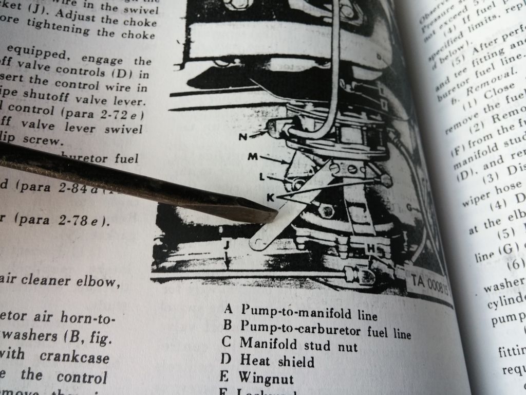

I hit it the other day and I looked it up and cant find a description or what it does on the pump? - Thanks
The screw driver is pointing to it.

Primer lever.

You pump it up and down to prime the pump? Should it just be in the down position or does it matter?

Yeah, its a manual primer. Its spring loaded so it finds its own position to sit in.
Pretty handy for filling carbs after a rebuild or running out of gas.

...and excellent for setting a wet float level!
