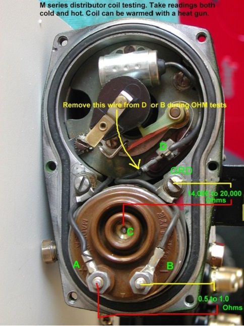

The other I was in search mode on Midwest Jeep Willys parts site and I found out that there was a 24 volt condenser for sale, so I went back to the shop and look for that condenser on my m37, I didn't find one,,Question; do I need one for M37 1953, Canadian version? :?:

should be located @ 12 O'clock under the distributor cap some times you will find two 12v condensers crammed in there.

Well, I did look there and other place, but no luck.

if your truck is on points you need a condenser. if you have a petronics kit a condenser is not required

Well well well, went you right (should be located @ 12 O'clock under the distributor cap some times you will find two 12v condensers crammed in there.) I didn't understood underneath the cover it self, so that wy I couldn't find anything the thing it self--INSIDE was were to look, that's all the deference for me to translate in french. But the end result is that , I'm pretty sur to find them inside when I remove the cap tomorrow.

Richard.It should look something like this once you take the Distributor cap off.
TESTING COIL1.jpg (116.97 KiB) Viewed 1763 times

thanks ,,it was in there,,,,,,,,,,,,,,,,,,,,,,,
