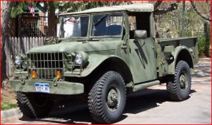

And here she is now....my daily driver, year 'round
