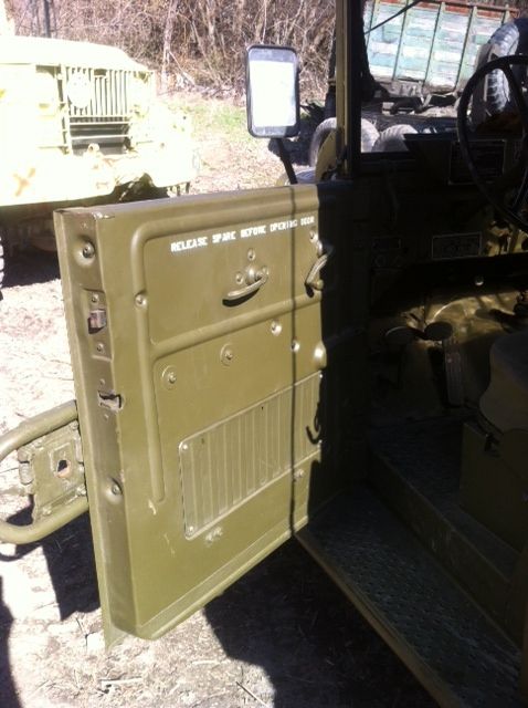

Well today in my frustrations that I continue to keep forgetting that I have installed the spare rack on the door. I made a attempt to fix the issue!!! :D

The spare rack on the door is a pain only if you don't do a simple fix:
Drill out the top rivet in the little rubber block just forward of the latch hole, at the edge of the door lip.
Close the door and the rack.
Drill through (1/4" size) the door lip, using the hole in the rubber block as locator.
open rack & door, then insert from inside door a 1/4 X 1-1/2" cap screw, through a piece or 1/4" rubber tubing 1/2" long, then through the block and rack, using a Nylok nut on the outside.
Adjust the tension on the new screw to allow the door and the rack to both latch with a usual slam.
You have now joined the two items together, and they will track just fine like that. When you pull the door closed, the tire comes with it. No more having to roll the window down and pull the tire closed.
I first saw this on trucks at the Yuma Proving Grounds, so I did it on my M-37's years ago and never looked back. The tire on the door is so iconic, and keeps rif-raff away from you.
Pow

Wow! Thanks for that little tip!
I have a copy (maybe it is an original) of the original MWO-ORD-G741-W7 "Relocating the Spare Tire Carrier". There are some parts of this "service bulletin" that are very confusing, one of which is the description of a "sliding door bolt" mechanism on the outside of the door to make the rack and door work together. In all the years I've had the Door Mounted Spare Carrier, I've never met anyone who had this part of the kit, or knew how it worked. After reading your description it now all makes sense.
So, once again, thank you very much! :D
