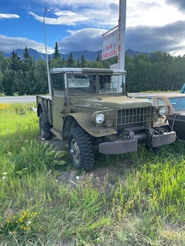

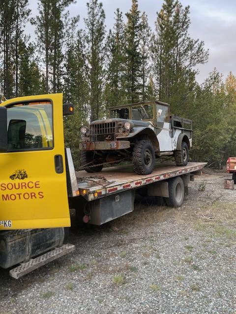

Here are a few pics,i thought i had added the US one to the registry but couldn't find it again
power wagon 1.jpg (38.88 KiB) Viewed 8565 times
power wagon 2.jpg (35.02 KiB) Viewed 8565 times
It looks like some more investigation to try and find the origins of the Canadien one

The Canadian one is the one on the roll back right? At least the camo on it certainly looks like what you see on trucks from the prairies. Can we see some more pics?
If you take a look on the drivers front frame rail, on the top just before the bumper you should see some stamped #s
Should be something like 53-xxxxx
This is what passed for a serial number in the Canadian army. Unfortunately, you can’t tell much from it as the records were purged long ago. You might also find this number under the paint on the drivers door, or possibly on the dash.
There should still be a frame serial number in the usual place as US trucks, unless it was obliterated at some point.
