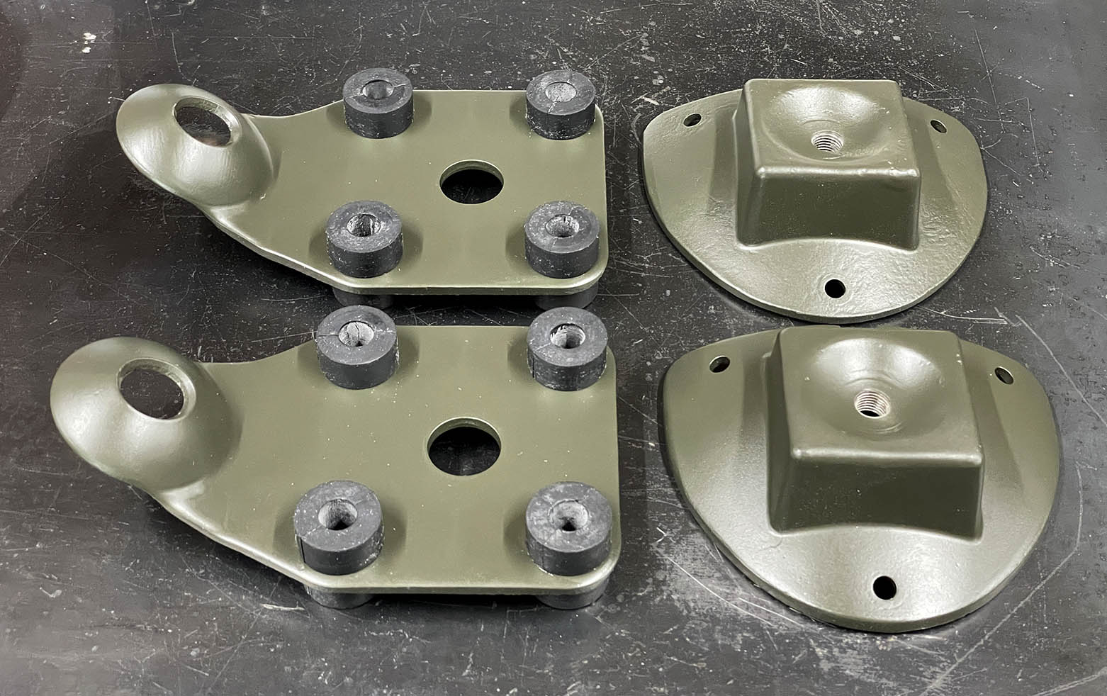

I just started restoring the headlights on my 1954 M37. I blasted, etch primed, and painted the brackets that mount the headlights on the fenders, as well as the zinc/pot metal brackets that go under the headlight bodies.
I just received a set of replacement rubber headlight mounting bushings/grommets today from MIdwest Military and installed them in the headlight brackets. I would NOT say that they were fun to install, although once started in the holes, they slid in fairly easily until the bracket snapped into the groove in the bushing. I managed to insert them with no tools other than my fingers and a little grease, but my fingers are a bit sore. I'm sure it helped that the rubber was reasonably pliable. I also left the whitish waxy storage coating on them when I installed them, as I figured it added a bit of lubrication for installation. I'll clean it off later.
If the rubber of your bushings/grommets has hardened up over the years, they would be much more difficult to install.
