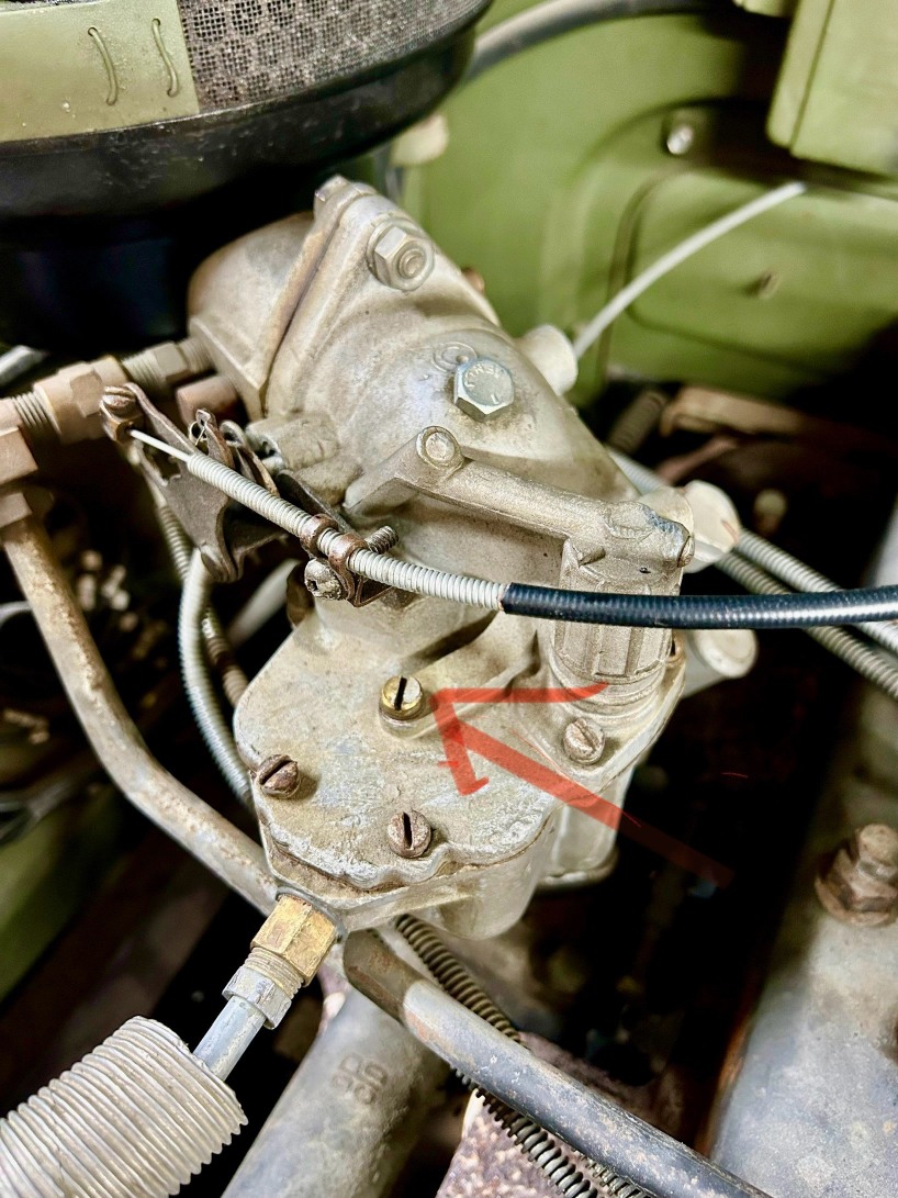

The choke appears to work just fine. Moves back and forth when pulled. Here is a pic of the carb and the screw i had to remove to add fuel. According to the manual i have this is called the "main vent tube".
Re: Losing fuel prime
So, what you don't know is if the choke plate is in the intake tract and if it moves.
But you are "lucky" that someone drilled an extra hole in the airhorn of the carb and plugged it with a bolt. You might be able to remove that and see if the choke is closing.
The actual bowl vent is along the side of the airhorn and in front of the choke plate.
So when the engine is turning and the choke is closed there is a low pressure behind the choke plate and a higher pressure at the vent. The higher pressure flows through the vent into the bowl and presses on the fuel in the bowl. This forces the fuel through the main jet and into the throat of the carb and into the intake manifold. (Low pressure area)
If choking doesn't cause a lot of fuel to enter the intake, some passage in the carb is blocked.
