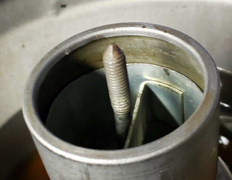

I'm trying to find what gasket is used under the oil bath air cleaner between the mounting sleeve.
There's no reference that I can find. Make one?
Cork. Rubber, Leather?

I need to take a better look but it seemed to me no bolt holes are required. It just sits on top of the air cleaner mounting sleeve. Between that and the air cleaner assembly.

Yes. The oil bath seals at the top of the sleeve (a simple smaller doughnut sits in the groove). Oil bath does not touch the bottom where the 4 holes are that attach the sleeve to the elbow. That's what I thought he meant.

Murf wrote: Wed Feb 28, 2024 2:41 pm Yes. The oil bath seals at the top of the sleeve (a simple smaller doughnut sits in the groove). Oil bath does not touch the bottom where the 4 holes are that attach the sleeve to the elbow. That's what I thought he meant.
Absolutely correct, thank you! Without the explanation and actually removing everything it wasn't obvious.
Mine doesn't have the doughnut, need to fine one.

I decided to use a leather shoelace in the groove of the cleaner. The stack is sharp and I feel would cut through rubber in short time.
After a test fit and adjustment the leather was able to be stuffed in the groove. The cleaner now fits on the stack with a good seal. Will it last? Time will tell but I have many old leather shoelaces.

Rdinatal wrote: Tue Mar 12, 2024 2:02 am Next is to figure out something for under the wing nut.
For the metal to metal wing nut contact area I was able to reduce the internal flare with pliers. That flare prevented the removal of the wing nut.
A large rubber washer covered by a metal washer now sits between the wing nut and the cleaner, both 1/2" hole. You can put back the flare to retain the nut in the top, but I didn't at this time.
Now the retaining wing nut screws down tight without the wings contacting the cleaner top. Nice seal!
