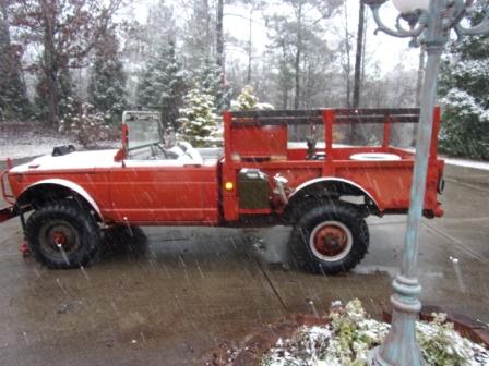

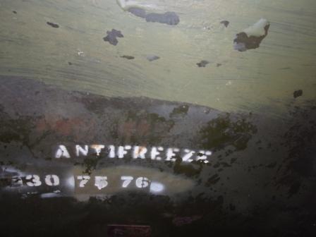

One quick pic in it's Bubba fire department configuration. Used to spray weeds and Kudzoo around fire hydrants and power poles. Still has a lot of the military bits and pieces including all data plates, two battery hold downs in the battery box between the seats, black out drive light bracket on the hood and even a anti freeze stencil under the hood that indicates it was in the military until at least 1976. Game plan is to put it back as close as I can to 1968 US Army configuration and mark for my brothers service.
