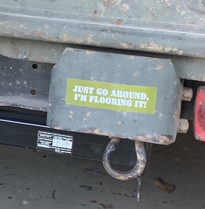

My alternative to the slow moving vehicle sign (given to me by Tim Holloway):
Just go around.jpg (59.42 KiB) Viewed 2630 times
