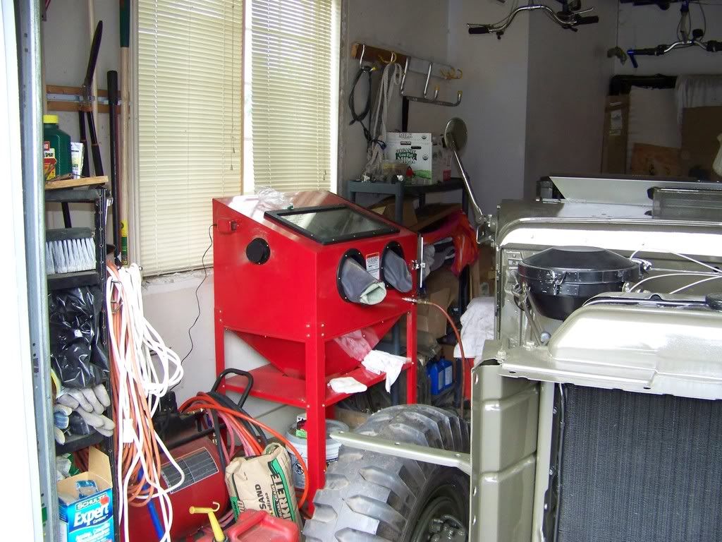

I bought a blast cabinet for $299 and it was the best thing. Doing the hundreds of bolts, brackets, hold downs for the M has been great. We blast a bunch of widgets, wire hang them on a rack, and then hit them with 2 coats of epoxy and 2 coats of enamel. We found that using the chemical stripper to take off the first 5 coats is best and then use the blaster to clean and remove rust. My Craftsman 5hp is going to take a dump here one day, so right now we are using a small in-line separator.

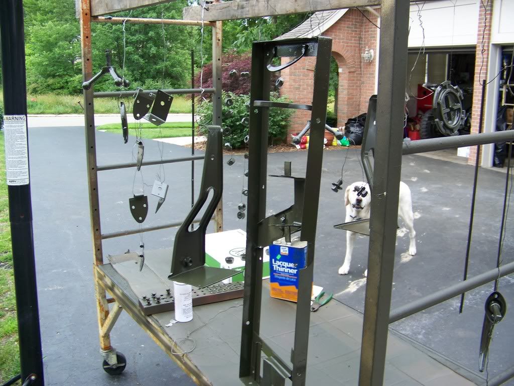

Here is the cabinet we bought. Does a nice job working off a 5hp compressor. We blast the parts and then hang them on a set of rolling scafolding. Wipe them down and then roll them out into the driveway (down wind) and apply 2 coats of epoxy and 2 coats of enamel. Great for bolts, widgets.
The dog knows to stand clear when the cart rolls out!

Looks like the same cabinet I have.
