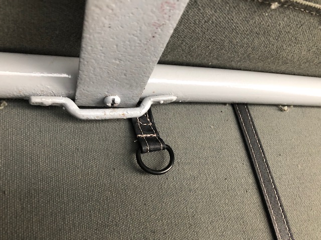

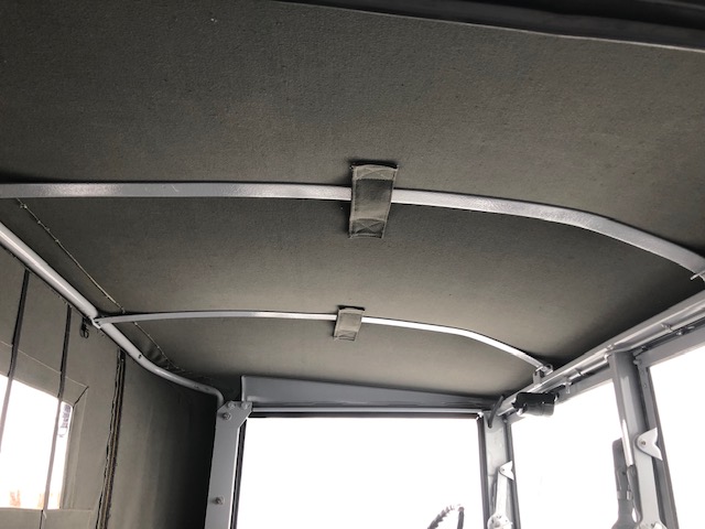

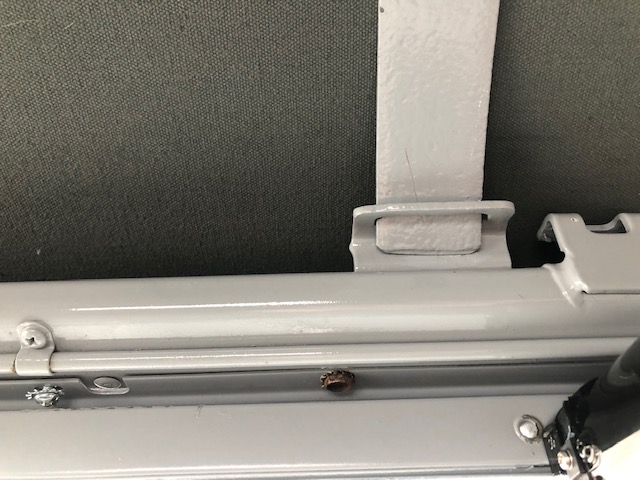

When I bought Fiona, the previous owner had removed the straps and installed two metal bows to keep the top tight and prevent water pooling. I think they are genius and am happy to share them with you all all who may be facing the same problem. The first phot is an overview while the second is the connection welded onto the windshield and the third is the connection on the rear bow. You guys have been so great with help for me, I hope this can return the favor!
Have a great week,
Dennis
Have a great week,
Dennis
- IMG_0863.jpg (117.94 KiB) Viewed 1920 times
- IMG_0862.jpg (86.49 KiB) Viewed 1920 times
- IMG_0861.jpg (67.57 KiB) Viewed 1920 times

Interesting!! They even have an arch to them.
Re: Cab waterproof cover
I wonder if the bow kit for the M35s would work in the M37? Basically it was three 1/4 inch or 5/16 rod that had a arch like the ones pictured and they had a 90 degree bend at the windshield to pop down into holes that were drilled into the windshield and where they attached to the back bow did the same thing. Just a wondering mind thinking out loud. LOL!
