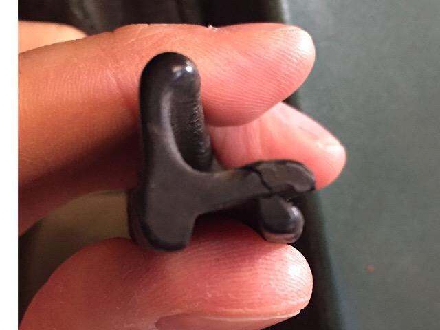

Guys can anyone take a close picture to the door seal?

Post by RCrombie »
I’ll take a look at what’s on my truck, and post a picture if I can. A lot of it is pretty old and flattened so I don’t know if it will be of any use.

Okay, here’s what’s around the window on the truck. All the rest of the rubber around the door appears to have disintegrated, so I guess I’ll be adding that to the to do list...
Let me know if this helps. I can also get measurements if you need them, I just didn’t have time to today.

Post by vit16 »
very nice! thank you RCrombie!!
it is very different from what I have. Mine it's just an "L" like what I draw in the first post.
again thank you!!
