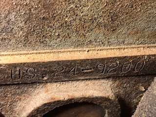

Gopher
Posts: 10
Joined: Thu Jul 09, 2020 2:12 pm
Re: Identify Engine by numbers
Post by Gopher »
Eng #.jpg (64.19 KiB) Viewed 1771 times
Thanks for the Info Yes the number is stamped on a machined boss on the left front of the block just below the head surface.
"SHINE" won't earn a dime
CHROME won't get you home
Posts: 852
From what I can see it looks Dodge-like. Does the oil fill tube bolt on or press in? If it bolts on and it's a Dodge 23" engine I'll bet it received a replacement block at some point. The motors in these things were likely swapped a few times in service and then who knows what happened to 'em once in civilian hands!

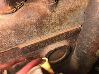

Gopher
Posts: 10
Post by Gopher »
block close up.jpg (46.54 KiB) Viewed 1726 times
Yes the oil fill tube is held in by two bolts through a flange just above the bottom of the block.
I have a close up of the stamped # on the block
Posts: 852
Joe,
If the oil fill tube bolts on it's a military block. It may have been a new replacement block???? Someone here may recognize the #. At the end of the day it doesn't really matter to much if it's in good shape :).
