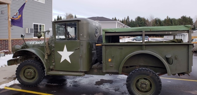

I found this truck in January, previous owner and his father had rescued it from a pig farm here in Northern Wisconsin about 15 years ago I drove it home 60+ miles in the snow. Ran great the whole way, the gauges are disconnected because wires were deteriorating, speedometer not connected either.
I have been told on another forum the bed is off an earlier M37??? Missing the rest of the tire carrier for the door, four blade fan, and the hardtop is likely off something else. Runs and drives well, will be a parade vehicle and something to enjoy with wife and my teenagers... occasionally drive to work/school or out for a trail ride.

Thanks Gary, some discussion that the bed was off an M37 (rather than a B1). It doesn't appear to be butchered and the wood platform between the bed and cab is actually convenient. It never had data plates on the door, so I am not sure if it only got so far as a cab and chassis in the military. I realize there weren't many M56 frames out there in total, so some people will scrutinize any mods it has.

How we got it:
The tires are severely checked, but they held air all winter. I have ordered some Trailworthy Fab rims and 37x12.5 Goodyear Mts as an interim solution.
Dash gauges disconnected by previous owner, so I have a new spider harness to put in
Winch works
Spotlight works
Starts, runs and drives after sitting.
I am putting a split exhaust on with stacks, as the current exhaust blows right someone climbing in (and troops in the back).
Selectro locking hubs on order, thought that might help with steering the larger tires and takes some strain off the front drive assembly.
We plan to drive and slowly clean up, replace missing bolts, spray a panel at a time while we enjoy this spring/summer.

Looks nice. Is that a gap between the cab and the bed?
(sorry, I missed the M56 designation-long wheel base) This is pretty rare!

That is right 14” platform between the bed and the cab.
Posts: 1274
Re: 1958 M56B1 Build Story
One of our local guys spliced in the front of a second m37 bed to an existing bed and made a long bed truck with two toolboxes. Might be an idea for you to try.
A lot of goodies on your truck. Enjoy!
And interesting mirror mounting locations, also.
