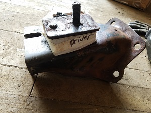

I'm not using the existing mounts. I've outboarded the passenger spring and lost that mount (trans). I'll make a separate trans mount.
this is what I'm using for motor mounts. Still need some trimming but free. Think I have everything in the right spot now. Measured and the pass side bracket is shorter than the drivers. Will probably add a spacer or cut the drivers to make equal, space is getting tight for manifold on pass side.
