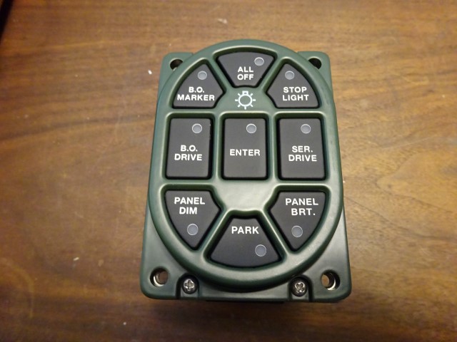

You could try one of these,,

06boblee wrote:You could try one of these,,
That looks too simple to operate. :lol:
I like when my hobbies frustrate me. It's a wonder I don't play golf.
Posts: 1246
Re: Light Switch Help
I think the pushbutton switch is cool. My current service army buddies tell me they are rather 'problematic' in use.
