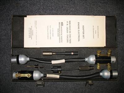

TM-9-8030 lists some procedures for testing the generator and voltage regulator, but they require adapters that I do not have access to. Is there a good way to perform diagnostics on the equipment without the adapters?

Borrow the adapters or you will need to make breakout cables to do the tests as outlined in the TM.

I guess I 'm making breakout cables, unless someone in central Indiana has a kit they are willing to travel with.
I'm assuming it'd need to be something with alligator clips on either end, with splices off for the volt meter hookups?
Posts: 1274
Re: Generator Testing
Alligator clips would probably short circuit to each other. I just bought a kit on line for like $60. The spark timing adapter was damaged but workable.

I actually have one of the Ignition kits above, if you're interested in purchasing it. I figure 50-60 is fair. Its in good shape as far as i can tell. If I don't hear from you soon i will likely just put it on EBAY. Good luck trouble shooting

Jesse19rap wrote:I actually have one of the Ignition kits above, if you're interested in purchasing it. I figure 50-60 is fair. Its in good shape as far as i can tell. If I don't hear from you soon i will likely just put it on EBAY. Good luck trouble shooting
Thank you for the offer. I picked on of these up through ebay a few months ago so I won't need one.
