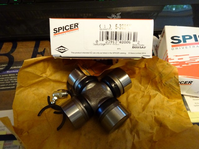

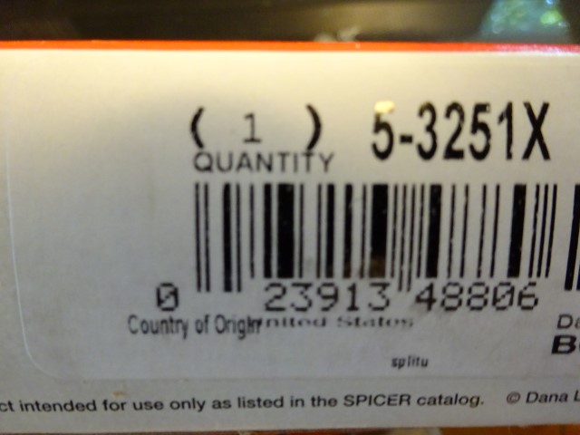

I found a Dana/Spicer 5-3251X. It is $38 on Rockauto.com. Still don't know if it is US.
Re: driveshaft u joints?
Got the Spicers: Says "Country of Origin- United States!"
DSC00891 (Small).JPG (88.3 KiB) Viewed 2122 times
DSC00892 (Small).JPG (113.17 KiB) Viewed 2122 times
I got a couple from AB Linn a while back, but the Spicer/Dana from Rock Auto seem to say it all, made in the USA.
