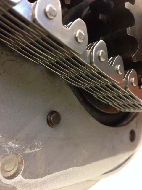

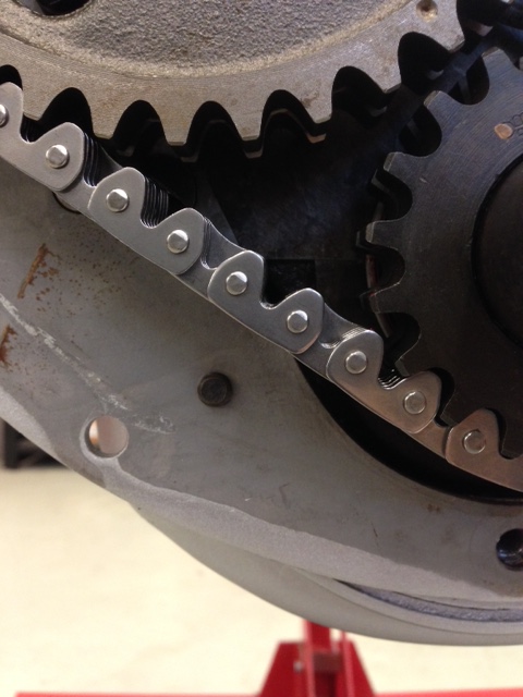

Here's some photos that may help:
Front Cover Bolt End View.JPG (97.92 KiB) Viewed 830 times
Front Cover Bolt Top View.JPG (105.67 KiB) Viewed 830 times
I will say if you have to swap bearings in the chassis it is nice that you don't have to pull the timing cover off. If you were to install a button head or flathead cap screw it looks like it would clear the chain and gasket area. In the photo you can just see where the gasket was.
