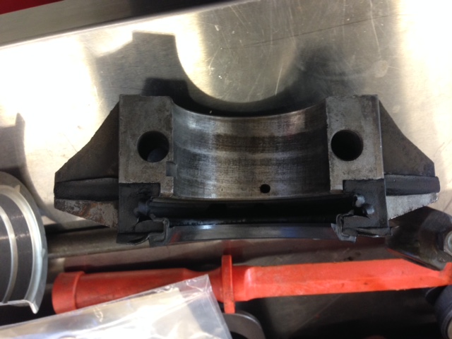

OK, so now test fitting some components of my 230 ci motor. I had bought a Best Gasket set, which did not include a rear main seal, so in my exuberance and haste to have everything ready for my motor, inadvertently bought TWO inside half circle main rear rubber seals. But today, when I was attempting to insert them, they just don't fit. The two halves are just too wide and don't appear to have the correct profile anyway. I think the rear inner seals should just easily slip into their groove, but there is not way these are going to fit. Maybe if I boiled them in water to soften them perhaps. Even with lube, they are a no-go.
So called M37' Garage, and spoke with one of CT's mechanics, and stated my situation and he believes I have an early motor and hence need the two part external rubber seal, attached to the two plate halves. I have three holes in the rear cap, and three in the rear block. So I have ordered a rear outer plate two part seal. But I recollect when I was by my machine shop I pulled out part of a inner rear rubber seal. And besides, he has returned every part of my motor to me, and there is no two part rear seal in the discard box. Here are two pictures of what I am dealing with.
The Best Gasket rear main seal is part #3675, "Dodge/Ply 6 218-230 '51-' 59, and Chrysler/DeSoto 6 '48-54.
here: [URL=http://s663.photobucket.com/user/h ... .jpg[/img][/url
and: [URL=http://s663.photobucket.com/user/h ... .jpg[/img][/url]

The rear seal looks like the two we've installed. Here's a photo:
rear seal.JPG (87.54 KiB) Viewed 2607 times
FYI, the seal in the photo you included is in backwards. Note the direction of the lip.
I will say that the seals we've used were not terribly consistent dimensionally. When you mock things up check the rotation of your crankshaft frequently as you go. Once we hit the final torque with the seal installed the seal bound up the crank! It took a bit of massaging to get it sorted. Seems the mold is a bit sloppy and left enough flash to effect the fit in the bore and pressure on the crank's sealing surface.
