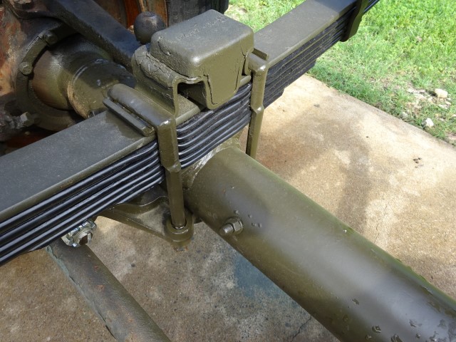

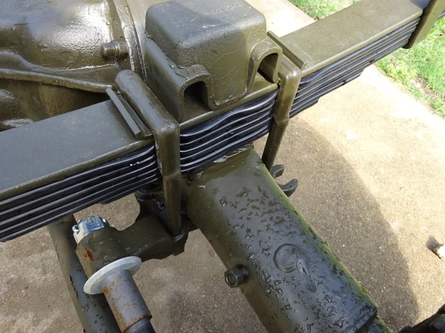

I already have my front springs lined with this, and am working on the rears (blast,prime,paint,etc) and was wondering if anyone has any experience using this stuff. When I torqued the u bolts down it is "squishing" the liner out.

I've read where others have used UHMW (Ultra-High-Molecular-Weight polyethylene) in thin strips (1/16" to 1/18")to gain better spring flex and prevent metal to metal rubbing and rust. They report great results.

The leaf springs on (most) all of those cars use tightly fitting leather "gaiters", only exposing the very ends and the center part where the "U" bolts are. Between each leaf is lubricated with engine oil, and oil is added to inside the gaiters during periodic lubrications.
I'm seriously considering trying that with one of my M37s, as there is nothing more supple than lubricated springs.
Oh, and if anyone is wondering, the gaiters do a great job of keeping abrasive sand etc, out of the springs.
As far as normal springs go, typically the individual leaves of leaf springs don't get painted, as the paint tends to make the leaves "sticky".
