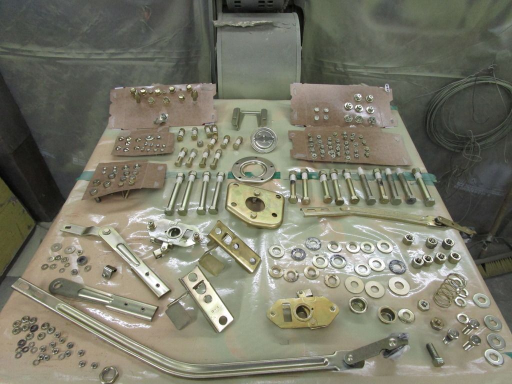

lots of bolts!
lots of bolts!
Do I paint them- or not?

I love the contrast of shiny bolts, however if you use the truck they will be red rusty in no time. you could do as I did and use a non alkyd clear.

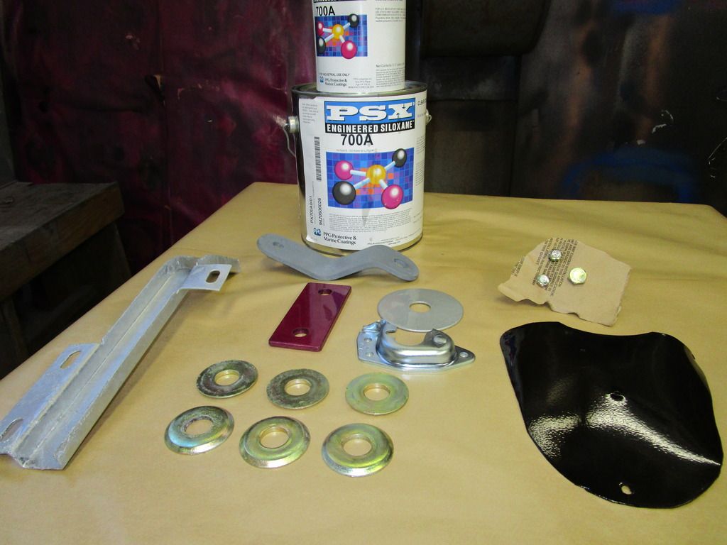

How do you keep from messing up the clear when tightening the bolts?
Re: lots of bolts!
electrical tape on 6 point sockets, and surprisingly the siloxane clear handled 45 foot pounds of torque

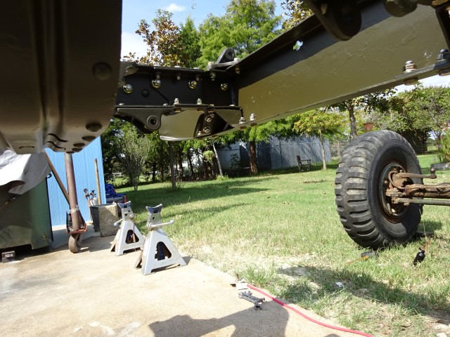

If you will notice in the pic, there some of the bolts that are turning "white"- these were the first bunch I installed. These are US made grade 8 bolts. If they are going to not stay yellow, I'm going to give everything a final coat of good old OD! I am seeming to go thru a lot more bolts and paint than I anticipated.

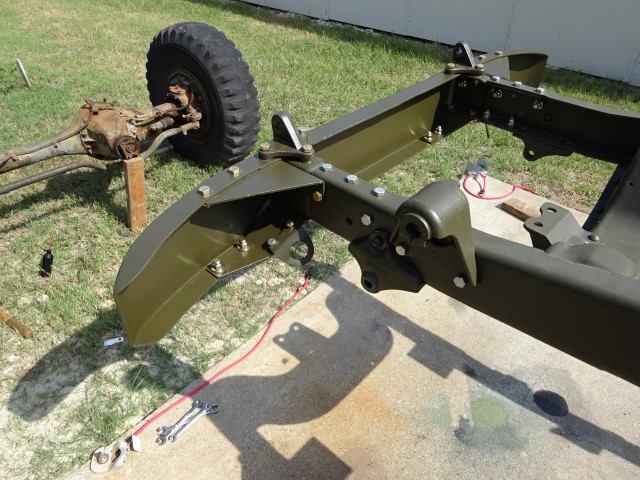

Re: lots of bolts!
More
