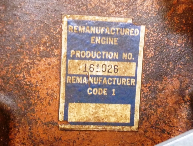

New M37 owner. Going to have the engine in my M37 rebuilt. I would like to have it rebuilt so that it provides optimal performance for the T245 type of motor. I do not want to hot rod it but getting it rebuild so that I can drive 55mph for a hour or two duration is desired. So if cam, dual carbs, and dual exhaust is necessary can do- with reluctance. However I would like to keep it M37-stockish as possible. Local engine builder has good reputation but he wants to know exactly what I want done, understandable. So I would like to ask for suggestion please.
Back in the early 1970 or '71 this M37 was transferred to a local county here in the middle of Illinois for Civil Defense service. Shortly after that it was made available to a local fire dept where it was acquired to be converted into a brush truck. That never happened so it sat ( indoors!) for the next 46 years untouched. I now have it and am in the process of restoring it to road worthy condition. Sort of good news is there are rebuild tags on some of the engine accessories some with dates of 67-68. Here is picture of rebuild sticker tag is on the engine block. Of all the searching I have not seen a rebuild tag of similar type so I suspect it may be commercial, or commercial govt contractor. Anyway the block is s/n: P24*405431* which indicated a Plymouth 218CI engine. Sigh. So the plan to take it in for rebuild. This way I can be sure that the internals are that which is required to realize a 230 build. And I can perhaps implement some of the suggestions made here. Thanks.

I wouldn't put too much faith in those rebuild tags. The tolerances acceptable in a commercial rebuild, especially one done for a government entity where lowest-cost is the driving factor, might not be as good as you would expect. Until you can disassemble the engine, and inspect and measure everything, you won't know what you have.

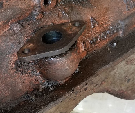

Here is picture of the oil fill tube flange. Upon closer look it appears to be a press-fit adaptation.

Thanks for posting that photo. I was wondering how a P24 Plymouth block came to have a bolt-on oil fill tube.Elgin554 wrote:Here is picture of the oil fill tube flange. Upon closer look it appears to be a press-fit adaptation.
