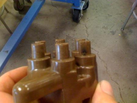

What's the resistance of a good distributor cap measured from inner plug terminal to outer plug terminal? I have 5 caps and they are all over the map.
Brown NOS cap 1: 5Kohms (in truck now)
Brown NOS cap 2: 5Kohms on all terminals but one, it's in the Mohm range, in truck when miss developed
Black cap 1: 10Kohms, tried in truck, ran same as above, removed while shot gunning parts...
Black cap 2: 10ohms on 4 terminals, Mohms for others
Black cap 3: one of the "pads" on the plug side of the terminal fell out exposing a small resistor????
When chasing the miss I pulled the dizzy/plugs/wires multiple times as I was unable to narrow it down to a single cylinder. Fun!!!
Finally I replaced the cap/rotor and was able to narrow the miss down to a dead plug wire in 3. The wire showed no signs of distress, even after removed from its sleeve.
I'd like to know if there's a resistance spec on the caps. I'm tempted to swap them in and see if they were part of the problem or not. Hate to save 'em if they are junk, hate to toss 'em if they're not!

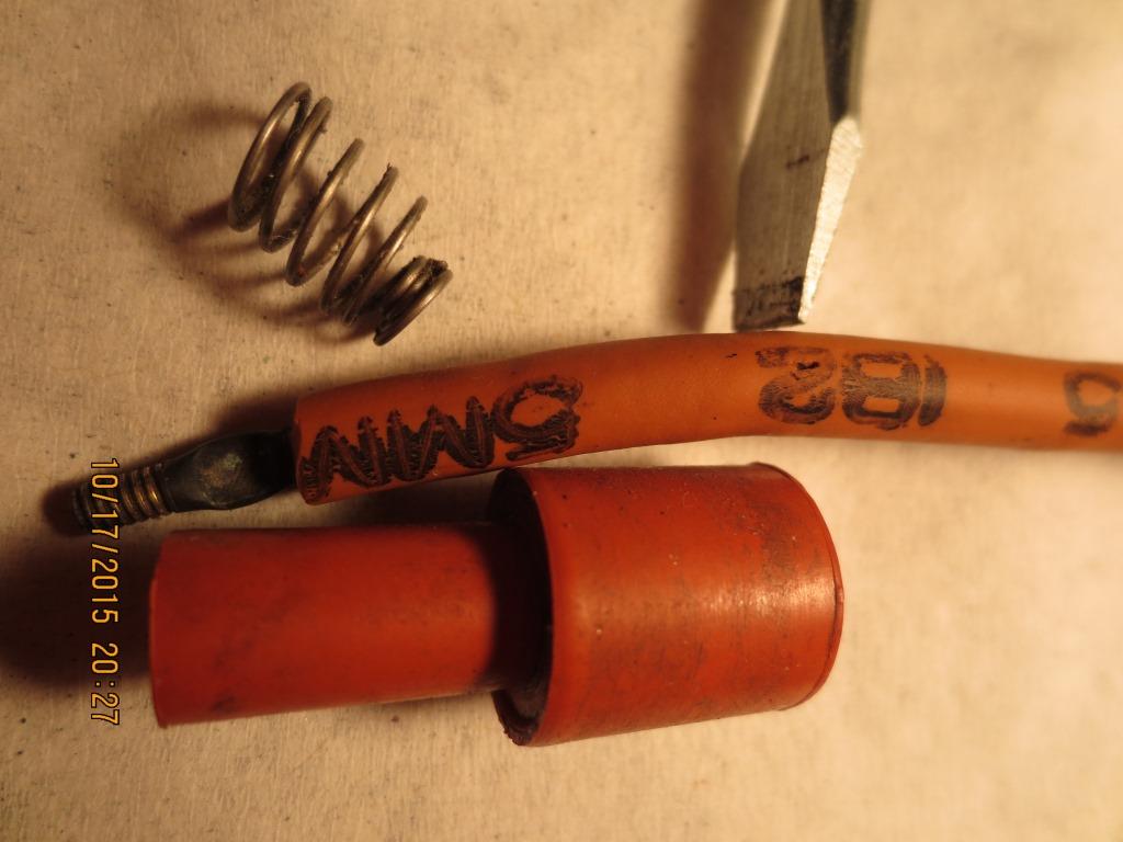

I found the bad miss by finding the sooty plug in 3 once I'd gone through the dizzy for the 2nd time and blasted around the block. I am not entirely sure if I have issues with some of the caps or not. Hopefully some of the crew will chime in. I don't really feel like pulling the dizzy to test all the caps...
The wire that failed only had issues under load, idle was fine. This made diagnosis a bit more annoying. The insulation had a pin hole and it was arcing to the outer shield. I'll try and post a photo of the failure, it's pretty tiny.
Edit: Added a photo of the area where the wire's insulation failed. It failed instantly, I opened the throttle to go around another driver and zap there's the miss... I suspect the wire was nicked when the students were pulling the plugs that day.
- Failure is at the base of the 2 near the tip of the screwdriver.

Wow, that's hard to see! Makes me feel better about having a set of new plug wires in the mail...
i didn't realize the wires just slide out of the shield like that, really makes me wonder if you could find the individual pieces for the wires. maybe i won't bother selling my short set, since it looks like they could be parted out and pieced back together into a full-length set
