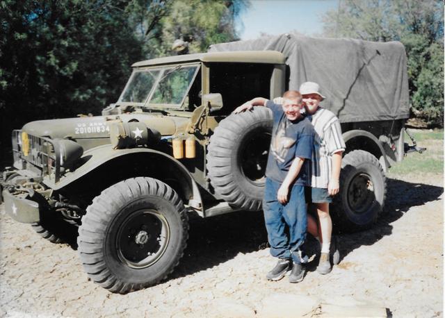

These are from back in the early 80's.
DG
Posts: 523
Re: My old Diesel M37 over the years

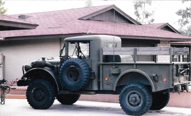

Late 90's early new century.
A couple young advocates of G741's...

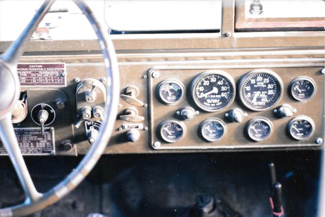

Nice job on the little details. The dash is great.

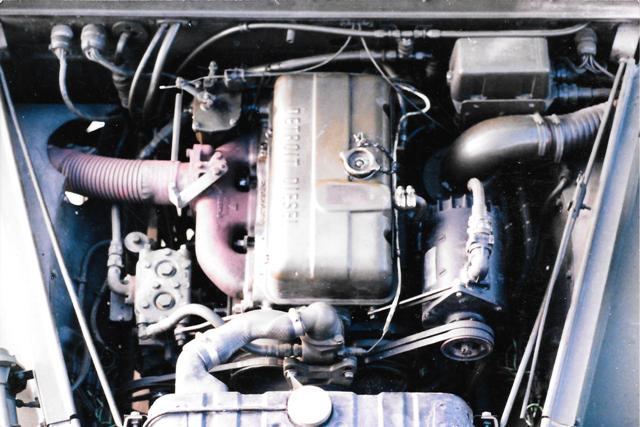

What is the engine series, 53 or 71 DD??
Don
Posts: 523
A 3-53N series. 159 CI.

What gearbox did you run DG and what was the dashboard panel from? (I want one ;-) )
MM
Trained Monkey on Guard
dodgem37@netspace.net.au
Posts: 523
Spicer 3053A from a 2.5 ton Multifuel. About 16% overdrive. The truck would make 68 mph at 2800 RPM, 5.83 gears and 42" Goat tires.
Dash panel from same, with one gauge hole added on the bottom with a relocated hi-beam indicator. It takes up about half of the original dash heater hole due to the increased width, and is a little taller as well. Nibbler tool surgery was easy.
