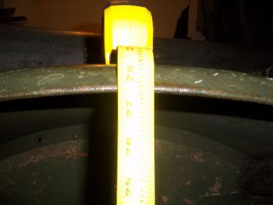

Gary,
Would you mind measuring the distance from the axle CL to the fender lip? It would give me an idea of where a truck on new springs sits. I'm more concerned about front driveline angles than rake and just need an idea of where these things sit.

I misread your request so this is a bit late (Just took this picture from the garage)-axle center line to the front fender lip is approximately 27.5 inches.
Sorry for the delay,
- fender height from front axle center line.JPG (12.79 KiB) Viewed 1582 times

I haven't painted my winch and bumper yet, but I mocked it up on the truck last night. 27.5" from wheel center to fender. It doesn't change if I step on the bumper, which is an additional 230lbs, so I guess I don't have to worry about excessive vehicle rake. I must spend too much time on my Toyota 4runner websites. On those sites, winches and bumpers often lead to an un-level stance and require suspension spacers. The Dodge is a different animal compared to the Toyotas
Re: Leveling truck
Looks like my truck is pretty close to Gary's. In my somewhat lumpy drive I average around 27.5". Guess the old springs are doing OK.
