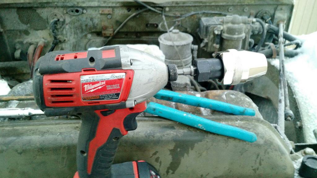

The one I got is made by Titan tools. There are much more expensive ones but I can't say they would work any better.
Here's a link: http://www.tooldiscounter.com/ItemDispl ... fgodrLIKNg
And here's a photo, I just used it with a 1/4" impact and an adapter, but I did have to break most of them loose with a ratchet, after using the impact to make sure the chuck was tightened down on the studs

Isaac, Is that basically a keyless drill chuck? Reason I ask, is that years ago, I bought a Craftsman 1/2 drive drill chuck and never used it. I had intended it for augers and an electric impact wrench that I already had but ended up buying a very large drill for the purpose. I ran across the chuck the other day, still in the box.

Jess wrote:Isaac, Is that basically a keyless drill chuck?
Similar, but it has a 3/8" square drive in the back for impact use. It's also designed only for removing things, the tighter you turn the back of it counter clockwise, the tighter the chuck teeth grab into the stud.
Somehow it's also fairly gentle, even using it right on the threads of the studs I could have easily re-used all the studs with just minor thread cleanup.
