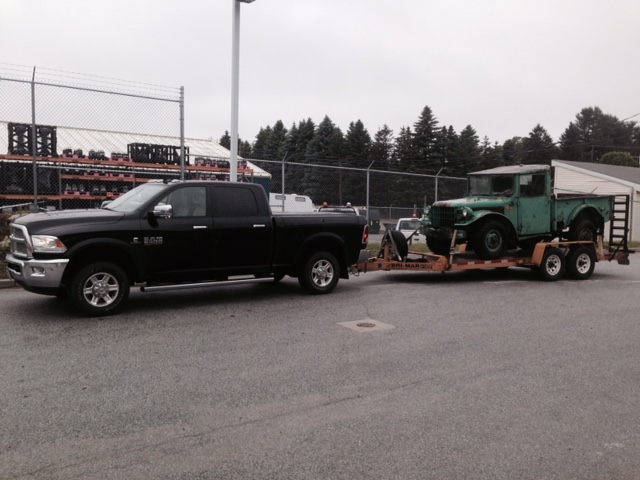

P.S Here is the day I picked it up.
230 overbore?
230 overbore?
- FullSizeRender(19).jpg (108.31 KiB) Viewed 717 times

Your picture looks like you have a solid candidate for a good restoration!
