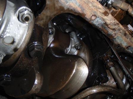

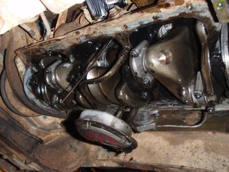

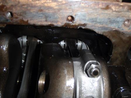

We pulled the pan today. From what I understand of the 230 oiling/filtering system it works like a settling pot, so I thought we should take a look. The good news is there was very little gunk and the internals of the engine are very clean. This is not what I expected due to past experience with this beast. From the limited view of the pistons and bores, things look good.
Is there anything the kids and I need to check while we have the pan off? I know enough about these things to be dangerous...
Any tricks to getting a leak free seal?
