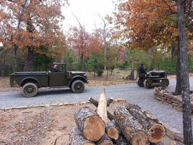

took the M37 out for a drive this weekend... started fine, took awhile to get warm as it was only in the upper 20's or something. went for a ride.
trip starts with taking me down my steep driveway, from the house, to a flat road, the flat portion a good 1/2 mile long. then up a slight grade upward, for about 1/2 mile, then onto flat road again. flat about another 1/2 mile.
driving down the driveway, the steepest part, she ran fine..like she always does. On the first flat area, again she ran fine. plenty of power I thought...nearing the top of the long grade, I got a sputter or two, like she was running out of gas. I continued after making this grade along the flat section (1/2 mile) and she ran good.
as my gas gauge does not work, and thinking I was running out of fuel, I quickly turned it around and headed for home.
down the long grade. no problem.. the long straight flat area, again no problem. but then again, there isnt much need for power as its all down hill, but still, she kept up the pace, as per normal, to power it along.
as soon as I attempted to climb the steep driveway, she just wanted to stall. no power. let off the gas, she returned to a nice idle.. several attempts to give it gas, under load resulted in it nearly wanting to die out. hitting the acelerator in NO GEAR, under NO POWER, she reved right up.
now it wasnt apearing to be lack of gas, or running out of gas here.
Had to drag it up the driveway with my little Cletrac Crawler.. (Yay for having that in the barn!)
wel, not having any time to look at it, and it getting colder, I left it until I return in a few weeks. So I need to arm myself wit hte right parts, if any.. Its at a remote location and I am limited to time and access for parts...
does this sounds like an electrical issue or fuel?

By the way, nice Cletrac!!

thanks for the Cletrac compliment. its a civilian 1952 model HG-42 that I went thru a few years ago. replaced all the seals, rebuilt or bought the bottom rollers, etc. motor was rebuilt in the fiftoes sometime (data rebuild tag) and runs like a champ...I added a model-T 4speed tranny installed between the clutch and the transaxle giving me ultra low range.. I made this a sort of sudu-military tracked machined based on ww2 photographs of the pilot experimental models they made for hauling mortars and such... its a lot different of course, as I left the stock pull bar in lieu of the pintle hook the experimental military machines had as well as the over sized ugly butt fenders they had for a flat top fender I custom made.
I now have a pull push/grill gaurd in place and I am adding headlights with headlight gaurds as soon as I get time (right!!)
all in all its a fun little toy I use to drag large logs out of the hilly terrain around my property to cut up for firewood. hopefully it wont be used so much to drag M-37 trucks around
