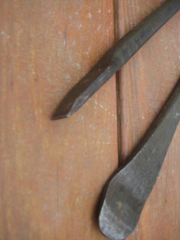

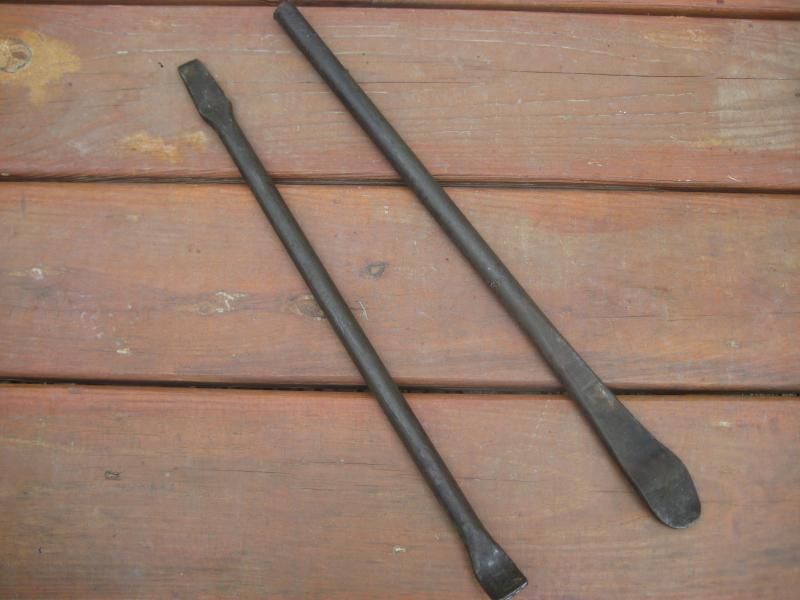

Two tire tools are necessary to do the job correctly, one a spoon the other a prying tool like a rolling head bar with a chisel end, stand on the tire to force it down where the ring ends meet, look for the notch in the rim, once located, drive the chisel end into the notch in the ring's right top edge when viewed from above, pry the ring out and up, catching the lower edge if the ring with the spoon and continue prying and lifting the ring around the rim.
