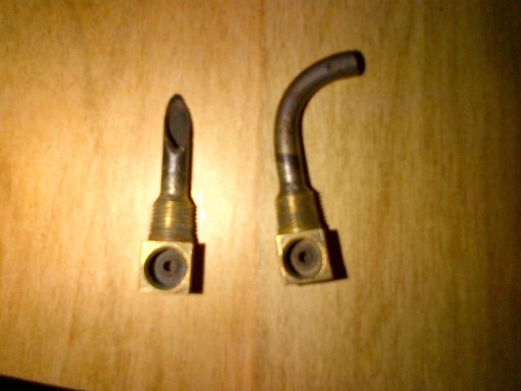

I was working on the carb, on my '51 M when I noticed one of the distributor vent tube fittings was stripped. The guys at VPW were nice enough to send me a couple of replacement fittings. Just as described. When I removed the original fitting to replace it, I found it was just a 90 degree 1/8" pipe to 3/16" tube fitting no brazed tube on the pipe end. Having read the manual TM 9-8030, I noticed that there should be 2 of the hooks pointed in opposite directions. The picture in the manual shows one on the side and one on the bottom of the air cleaner elbow. Both of the distributor vent lines on my M are on the back side of the intake neck about 2.5 inches apart and the tubing is attached from the bottom of the fittings.(the flare connections are pointed downward) I have not had a chance to remove the other fitting to see if it is indeed just another 90 degree fitting or if it has a brazed tube on it. But am confused about the 2 replacements that I received. I had asked for just one, so was wondering if they weren't sure what I needed and sent one of each type.

Is this where the slash cut type goes or are these both for the distributor vent.
The hook type that I received would work in the position closest to the carb. it would be pointed downstream with the tube connection pointed down. But if I put the slash fitting in the side of the carb. it would be parallel to the flow.
- intake-distributor fittings from VPWs.jpg (65.42 KiB) Viewed 1169 times

My intake elbow had the Slash cut style tube fittings on the fuel tank and master cylinder vents. The distributor vent lines had the elbow style fittings with one facing in each direction (upstream / downstream).

Any opinions as to which type (slash or bent) works best? I bent and soldered mine, but the slash cut sure has a lot of surface area, but the tube direction is not optimal. How about bent 45 degrees and slash cut? Just throwing an idea out there. I have not had any coil issues yet.
