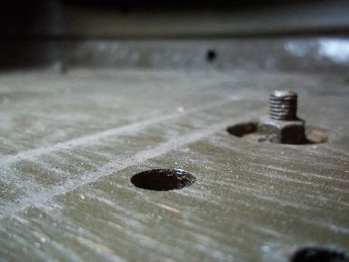

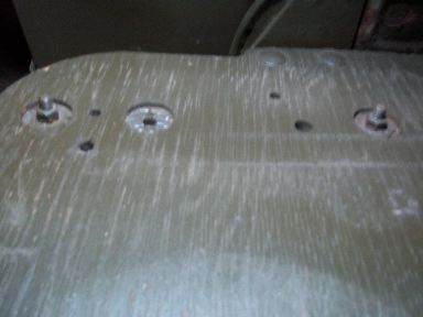

Post by Gerry »
On my drivers seat. The bolts that secure the track To the bottom of the plywood stick up into the seat. The bolts look like they may have been re-welded to the track at some time my question is should these bolts be flush with the plywood or stick up an inch like mine do. The Bolts are hitting the fabric on the underside of the seat and creating holes.
Thanks
Gerry

I recall the total length of the bolts being around an inch long-I'll take a look tomorrow then re-post, maybe with a picture, too.
Posts: 4354
Re: Seat bottom track bolts
Here you go Gerry:
dr seat bolts 1.JPG (13.46 KiB) Viewed 767 times
dr seat bolts 2.JPG (15.9 KiB) Viewed 767 times

Thanks Gary,
Pretty close to what I have.
